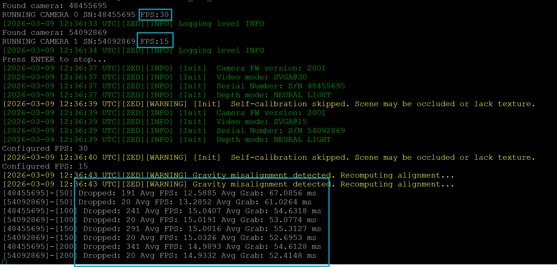

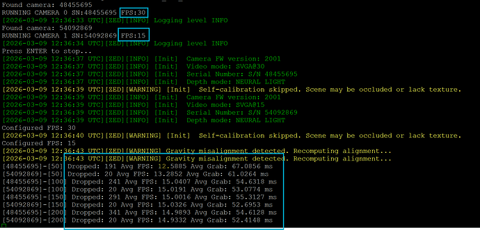

I noticed that If i have 2 cameras running different FPS it causes frame drops:
Occasionally my test app works fine and i can have 1 camera running at 30 FPS while the other at 15FPS with minimal to no frame drops but almost 9 times out of 10 i get this odd scenario where the camera set to 30FPS actually only runs at 15~ FPS its as though its being throttled / blocked internally..
Please find attached my little test sample app:

Regards,
David
Hi @dhutchinson
Are you connecting the two cameras to two different groups?
What version of the ZED SDK and ZED X Driver are you using?
I recommend you get the latest.
