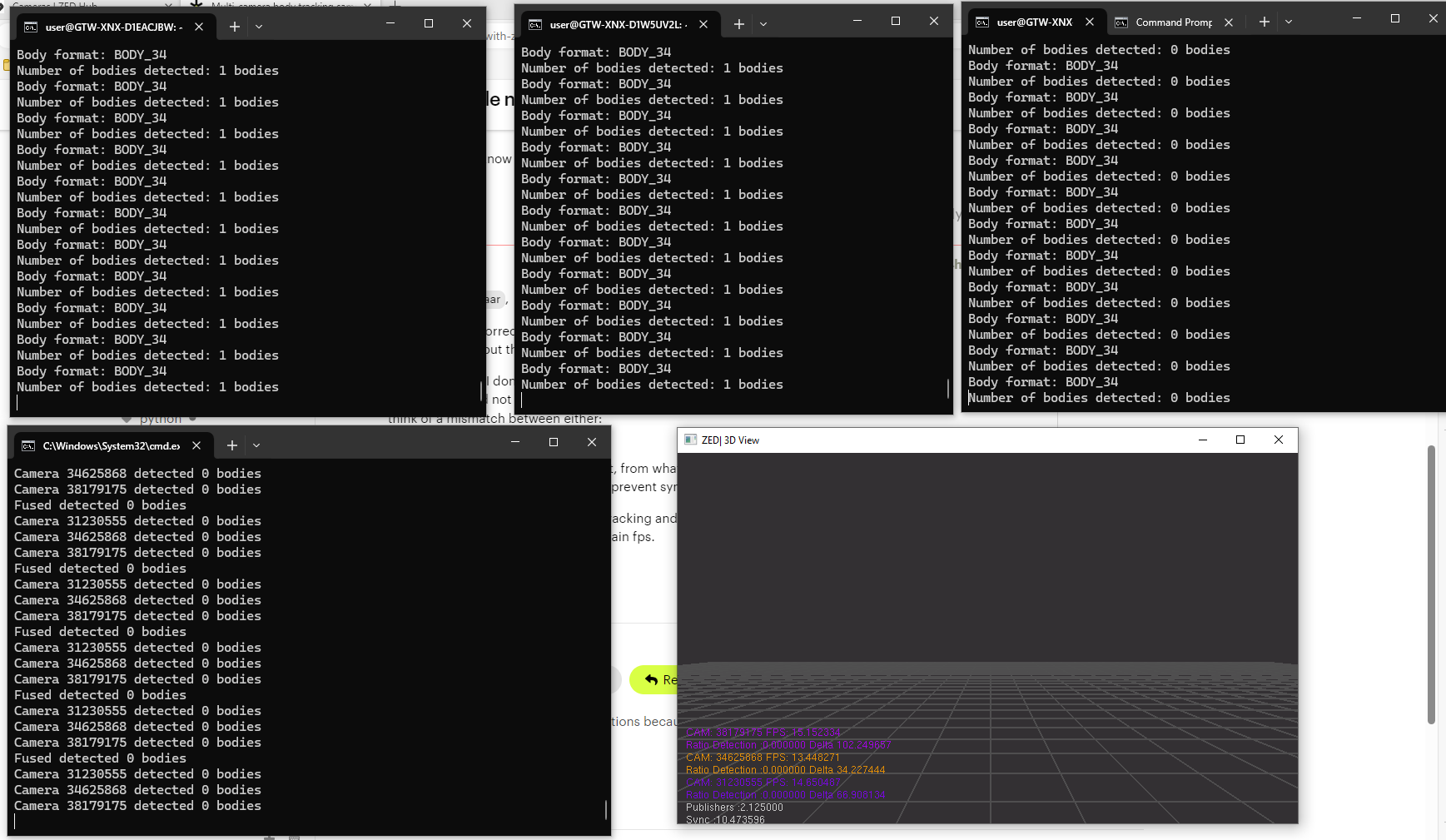

I also think it is strange why the code is not working - in the image below I’m showing the sender logs for 3 of the 6 cameras (upper 3 command lines) and the fused logs showing the receiver’s detection of each individual camera as well as fused. The fused receiver receives no body data from the senders although two of them are clearly detecting bodies. The cameras are connected to the receiver though, as you can see from the camera FPS shown in the 3D viewer.

  • All receivers are using body model 34. I have tried using body 38, and the sender are still detecting bodies, however, the fusion receiver is still not receiving any bodies. I have not specified a body model in the receiver - should I and, if yes, how?
  • I am using the Windows and Jetson (ZED_SDK_Tegra_L4T35.1_v4.1.0) SDK 4.1. Have you made updated to the SDK pre-release installers lately? If so, please send me the newest versions.
  • The FPS of the senders (as you can see from the image) is about 13-15 which should be good enough to run fusion…?
  • If I don’t enable tracking and fitting in the sender, the fusion does not work - I am not sure why - maybe this is where the error is?

Sorry for the delay in the answer, you’re right, there is an issue with that. :bowing_man:
We’re in the process of investigating this, it will be fixed for the official release.
