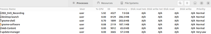

Appending an image below with running top
The MEM usage quickly accumulates to 65.7% in roughly three and a half minutes. The device had 16GB RAM.

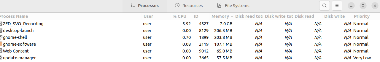

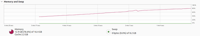

Please use a plot tool to monitor the live memory usage status (e.g. gnome-system-monitor) and verify that it effectively grows with no limitations in time.
Hi @Myzhar
The first process in the list is the recording process.
I can put only one image in a single post, the graph will be appended in the next post.
Then RAM usage just accumulates while keeping this process open.

Hi @Yjin
Thanks to your useful information, the team has already detected the issue and fixed the bug.
You will find the fix in the ZED SDK v5.0.3 that will be released soon.
