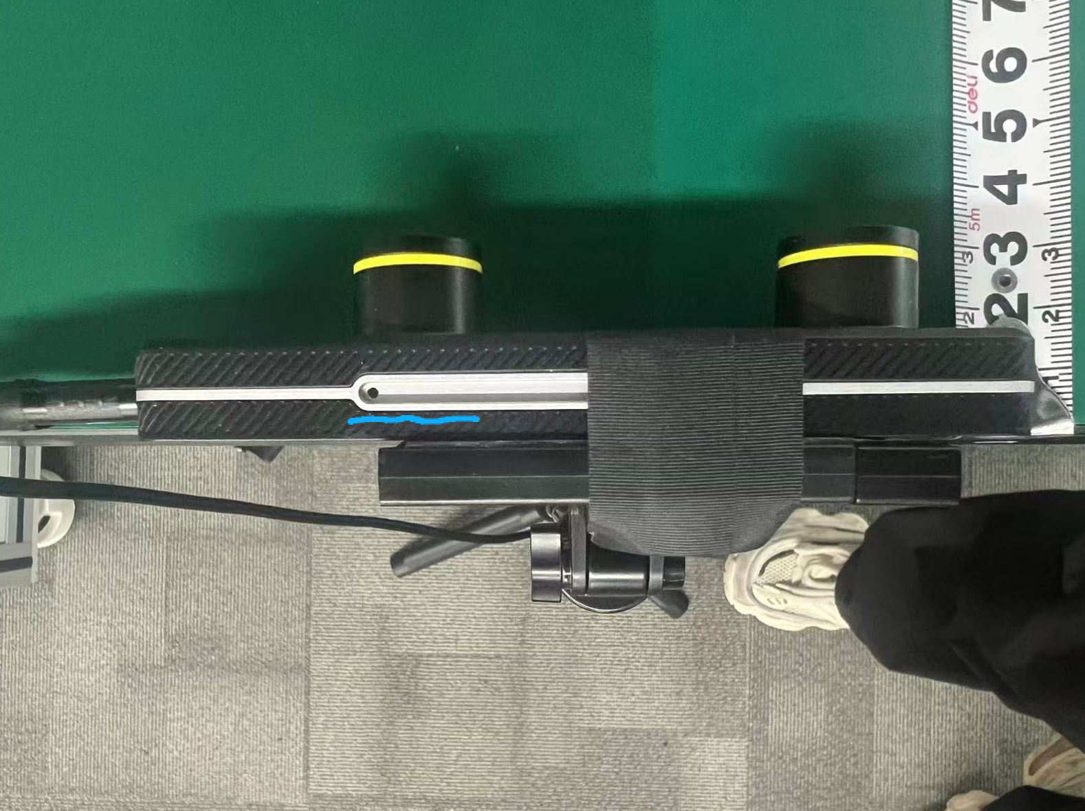

Regarding the statement that the coordinate origin is located 3mm from the back of the camera, does this refer to the position near the blue line in the attached image?
Assuming this is correct, I placed an object at a physical distance of 40 cm from this presumed origin (measured manually with a ruler). However, the ZED Mini estimated the depth of the object’s surface to be 37.8 cm, which means the error is over 2 cm.
Could you please confirm if the camera’s coordinate origin is indeed at the position indicated by the blue line? If it is, I believe the depth error shouldn’t be this significant.
