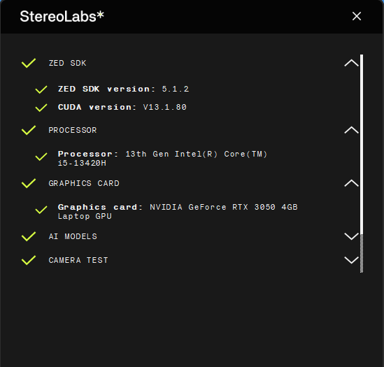

Please run ZED Diagnostic and share the content of the JSON file that it generates.
This is a screenshot. You must click the “SAVE” button when the diagnostic process is completed and send me the file it generates.
