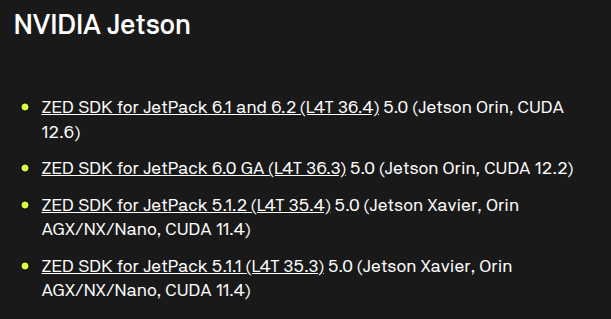

Jetpack 5 is up to 5.1.3. Can we get a Jetpack 5.1.3 (L4T 35.5) release of the Zed 5.x SDK?
Installing the Jetson SDK for 5.1.2 seems to work but I haven’t confirmed it’s fully working yet. I would feel better with a release built against 5.1.3.
Thanks!
Hi @JC31
Unfortunately, the ZED SDK only supports JP 5.1.1 and JP 5.1.2.
We cannot release versions compatible with other JP5.1.x versions.
