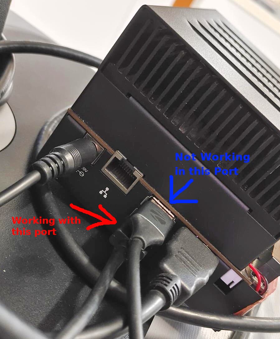

Yeah, I was able to compile the sample programs and run them. Thanks for the quick response. It was an USB port issue, apparently the Nvidia AGX Xavier board recognize the ZED Camera only when connected to a certain the USB ports, although the AGX Xavier has 3.0-USBx2. Do you have any idea why am I encountering such behaviour?

That depends entirely on the carrier board that you are using - probably its USB ports are not the same. Who provided the board ?
We got it from Digikey. Also, just to clarify things, both the USB ports are working fine with other USB devices like the keyboard, mouse, USB cameras… But for ZED camera, only one USB port is recognizing the device and the other USB port is not. So, I suspect that it might not be a carrier board issue. Hence, decided to the ask you guys regarding this kind of behaviour.

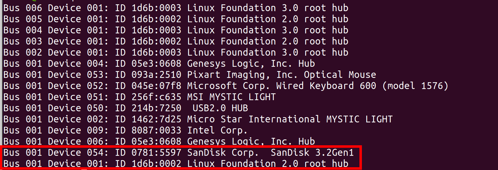

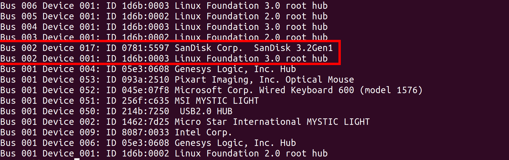

If you plug a USB3 device into the port, then run lsusb, you can determine what speed the port is by matching the device to the bus on which it is connected. Device 001 on each bus will be the “hub” aka, the controller for all devices of that speed.
These two screenshots show what occurs when I plug a USB3 thumb drive into a usb 3 port and a usb 2 port. Note that when connected to the USB 2 port, it shows as a device on bus 001, and therefore USB 2 only.
I check the Port capability using the method you suggests, it seems the port is really just a USB2 port event though it has 9 PINs. Maybe there might be some way to enable this port from USB2 to USB3. I’ll check for the possibility. Thank for the quick reply. It helped me save a great deal of time.
