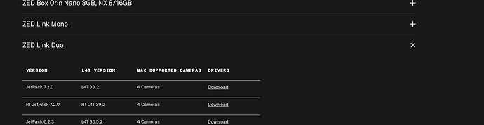

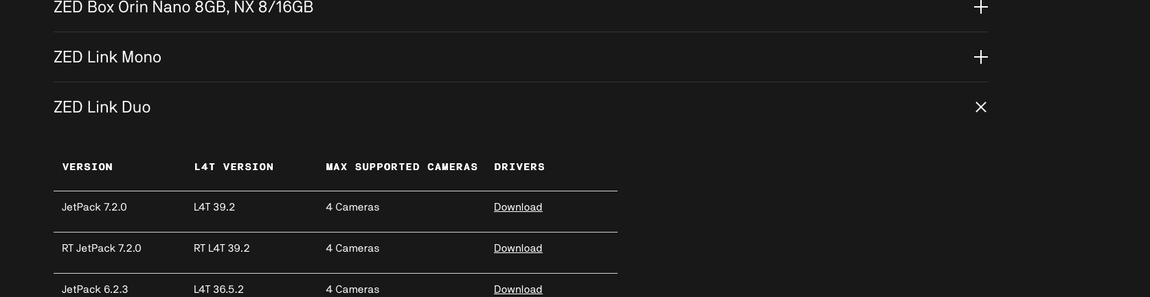

I see that the 7.2 RT kernel duo link driver has been removed from the download page, so I’ll wait until it’s brought back up and try again Stereolabs ZED X GMSL2 Drivers | Stereolabs

My apologies for the response delay.
Could you try again with the 7.2 RT kernel duo version that we recently patched ? https://www.stereolabs.com/en-fr/developers/drivers (see the attached screenshot for details).
Please let me know whether that solves your issue or not, and don't hesitate to ask any question regarding any other technical issue.

Thanks for your patience, and for the detailed logs. Our driver team confirmed that the previous 7.2 RT builds were not loading correctly. A corrected RT driver is now live on the download page: Stereolabs ZED X GMSL2 Drivers | Stereolabs
Could you uninstall the ZED Link Duo driver package you have now, install the newly published 7.2 RT version, then reboot?
