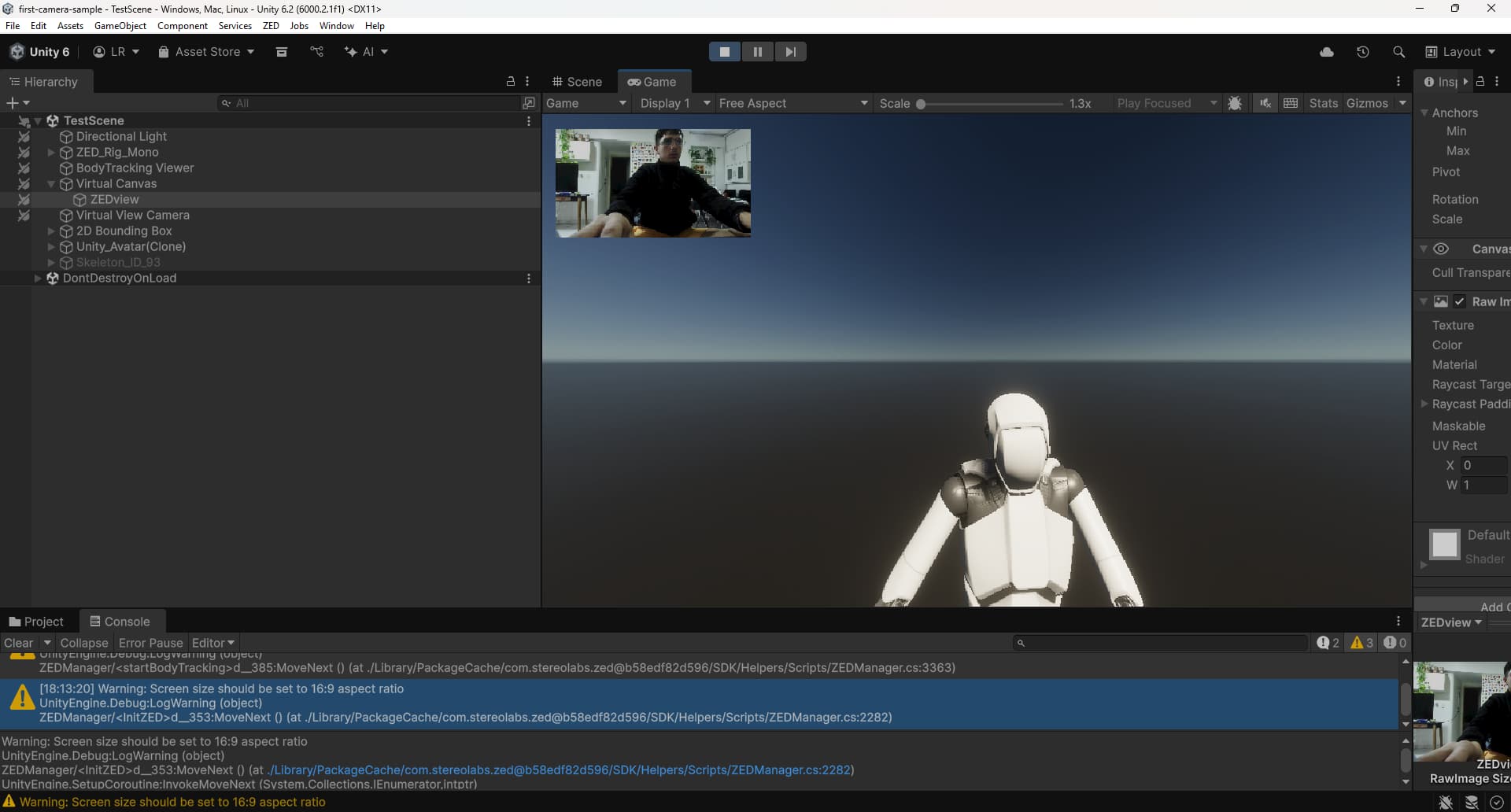

Hi everyone! First of all, I’m new in Unity. I have been working with the ZED 2i camera in unity in the last week, and I have a simple question: it is possible to use the camera in Unity using a screen size different than 16:9? Using the Body Tracking project sample, if I use any aspect ratio

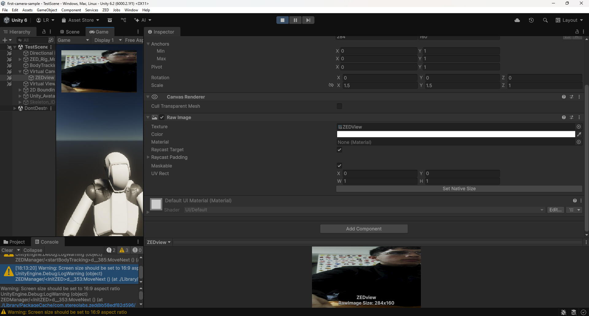

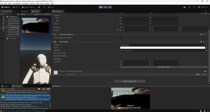

  1. The camera looks stretched
  2. I see the warning “Warning: Screen size should be set to 16:9 aspect ratio”
I’m focusing just in the camera view, we can ignore the skeleton rendered.
My use case is that I need, for now, to display the camera view in a 9:16 screen.

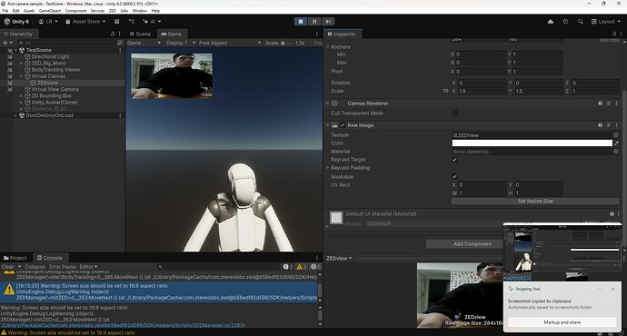

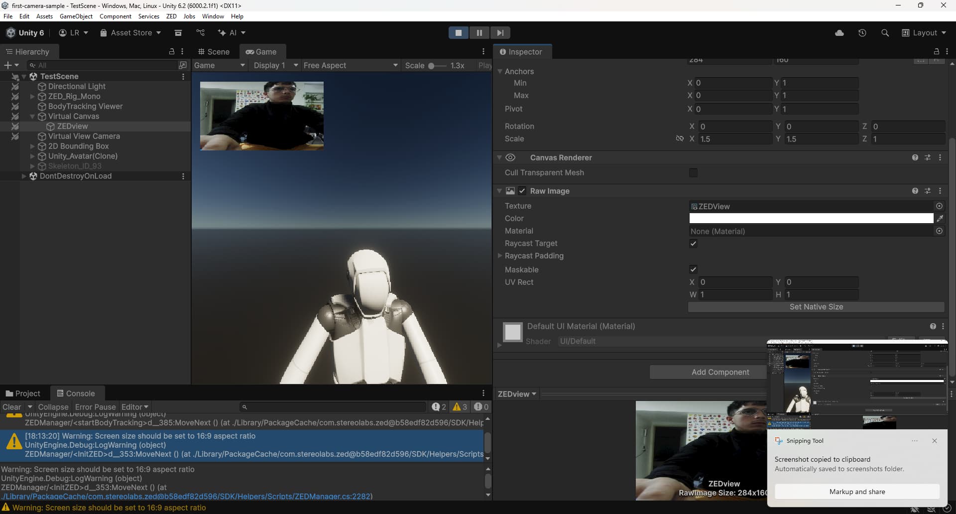

To understand the stretching, here are a few screenshots with examples:

The image output from the camera is at a 16/9 aspect ratio format, which is why you get this warning.
Using any other screen format would stretch/distort the image.
To prevent the image from stretching, you need to crop a subpart of the image at the correct aspect ratio instead.
