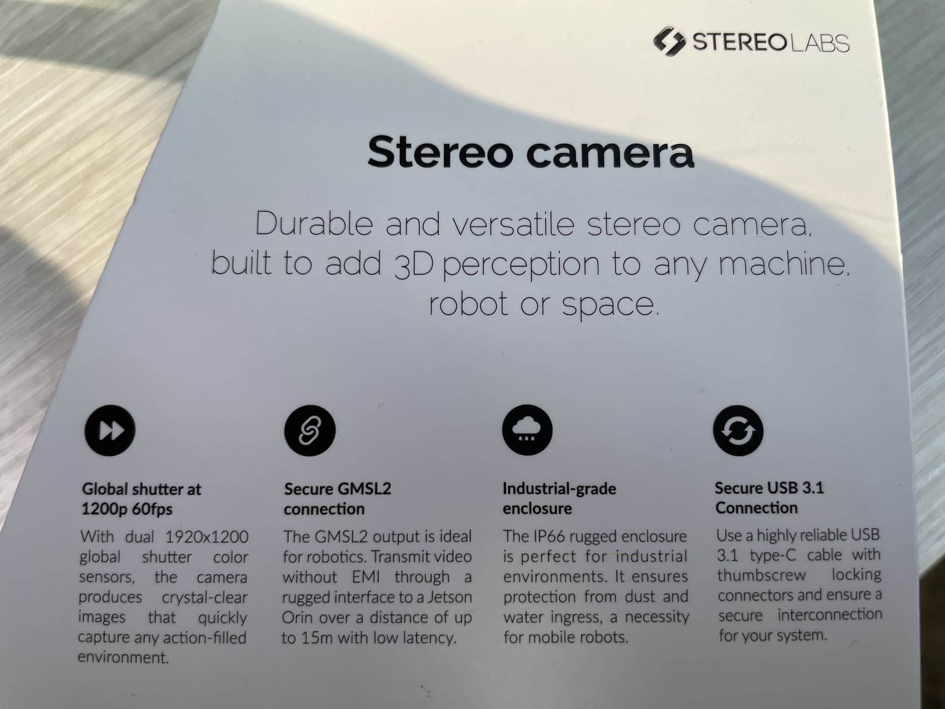

I purchased a ZED X mini and noticed that on the box there is wrote both “GMLS2 secure connection” and “USB 3.1 secure connection,” but on the ZED X mini there is only a GMLS2 connector. Is it possible to use a USB connection as stated on the box?
Hi @ValerioSpagnoli
Unfortunately, it is not possible to use the ZED X GMSL2 devices with USB3 cables.
I apologize for the wrong information on the ZED X Mini box sleeves. The box designer made an error and unfortunately, the first batch of cameras was delivered with this incorrect information.
