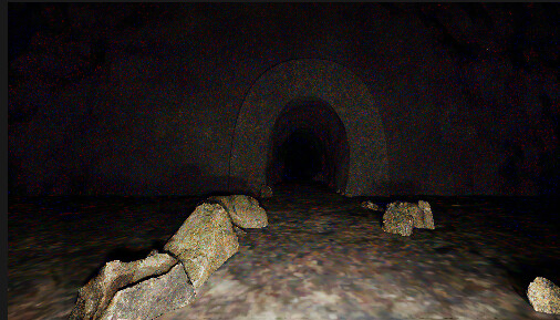

The pointcloud as it appear at the start of the simulation.

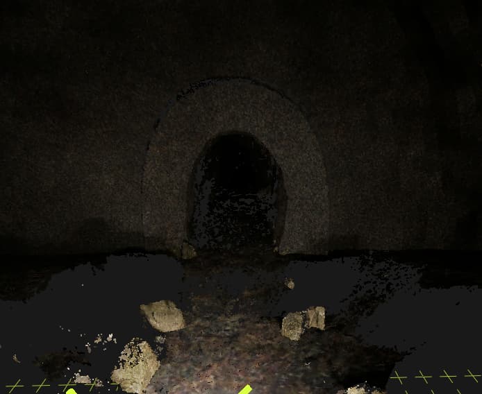

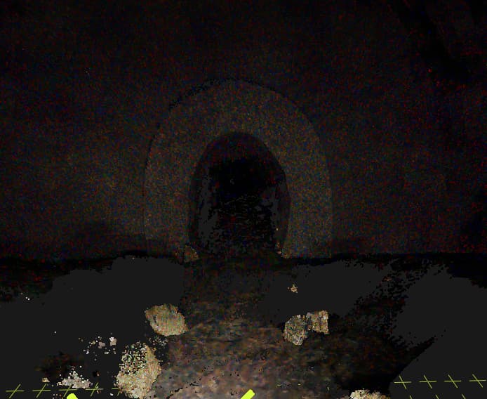

The Pointcloud after three minutes where the ZEDX is not moving.

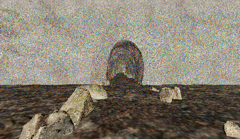

The camera has the same artifacts.

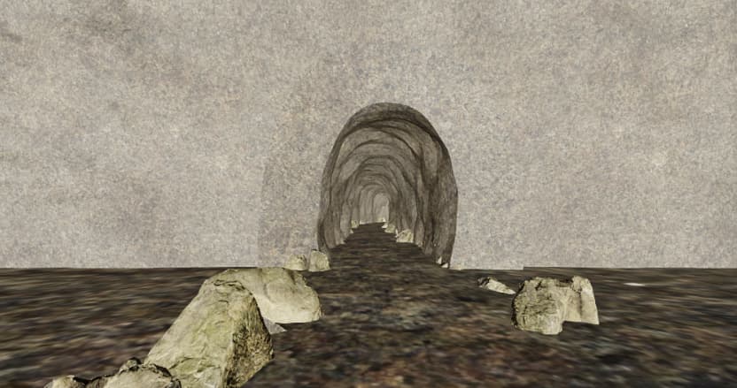

This is the isaac sim viewport (camera set to the left lens of the zedx)
This is the image from ZED_Depth_viewer (after around two minutes)
ZED depth viewer image
