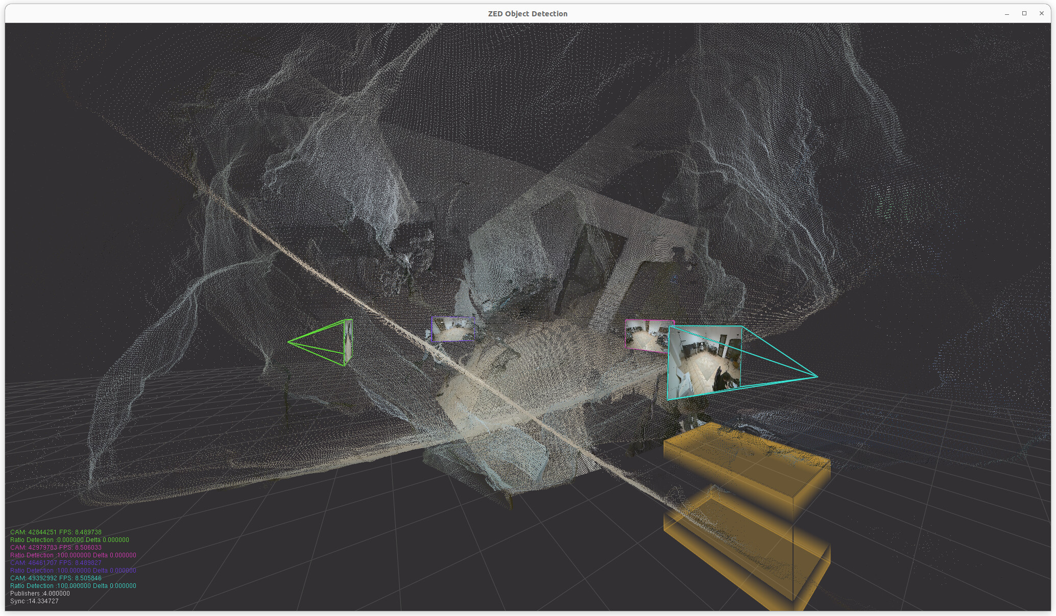

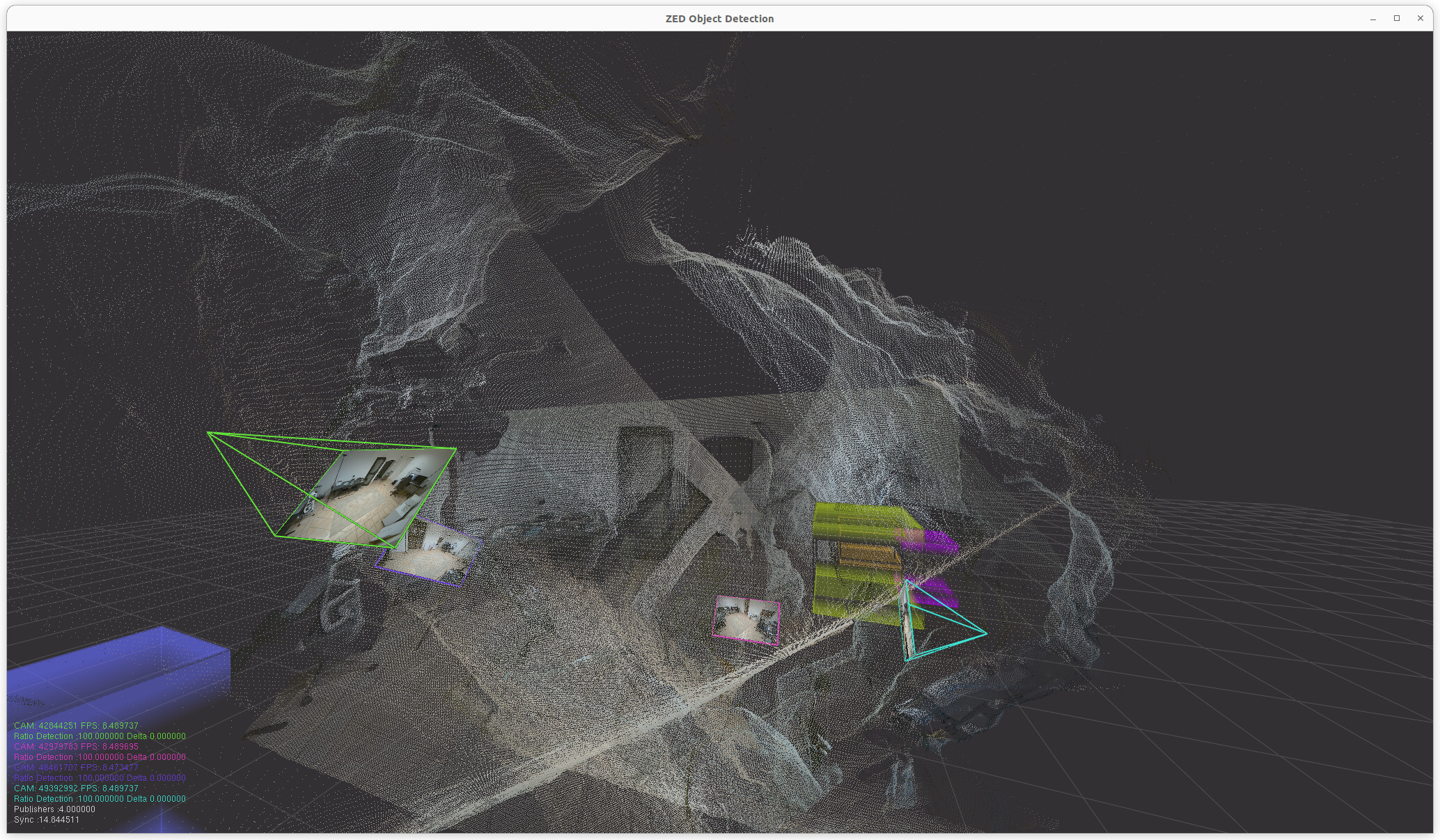

Hi everyone,
I’m trying to run the official C++ “multi-camera fusion” sample on a Jetson Orin NX (16 GB) with four ZED X cameras connected via GMSL2. I calibrated all four cameras using ZED360 (following the official guide) and verified that in the ZED360 UI they are positioned at the same height (forming the corners of a rectangle) and all pointing toward the intersection of the diagonals.
When I launch the sample (with my own JSON config from ZED360), I see:
Only camera 0 (the reference camera in my JSON) rendered correctly.
Cameras 1–3 appear tilted/shifted incorrectly in the GLViewer.
The fused point cloud is not fused at all; instead I get four overlapping clouds (one per camera).
Here’s a screenshot showing the problem:
What I’ve tried:
Verified JSON poses are correct (identity + 3 relative transforms)
Removed any Fusion SLAM calls (enablePositionalTracking + getPosition) to force pure static extrinsics
Ensured I apply each pose exactly once when drawing raw clouds (in that way, cameras are correctly drawn)
Still, each camera cloud remains in its own plane and the fused cloud is never combined (as you can see in the following screenshot)

Unfortunately, nothing changes. It seems like all the point clouds are displayed in their own coordinate system and not fused at all.
I took the code in github as it is, i noticed it also in the multi_cam_multi_model_example, like it is a problem related to GLViewer.cpp file
