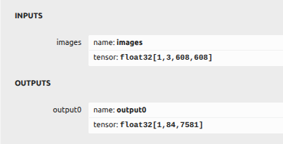

Could you post a screenshot of, like netron showing the shapes? For instance, here’s a compatible yolov8n with fixed size:
If possible, you could also share your onnx file to troubleshoot (it can be privately sent to support@stereolabs.com)
