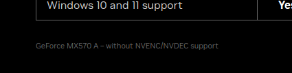

Hi.
It was Notebook with Nvidia Graphic card mx570
By the way, This issue has been resolved. There was no problem when I installed it on a server with a GPU that has nvenc.
Is nvenc an essential element when recording?
Unfortunately you cannot use H264 and H265 compression with NVIDIA GeForce MX570. It does not has hardware encoders.
