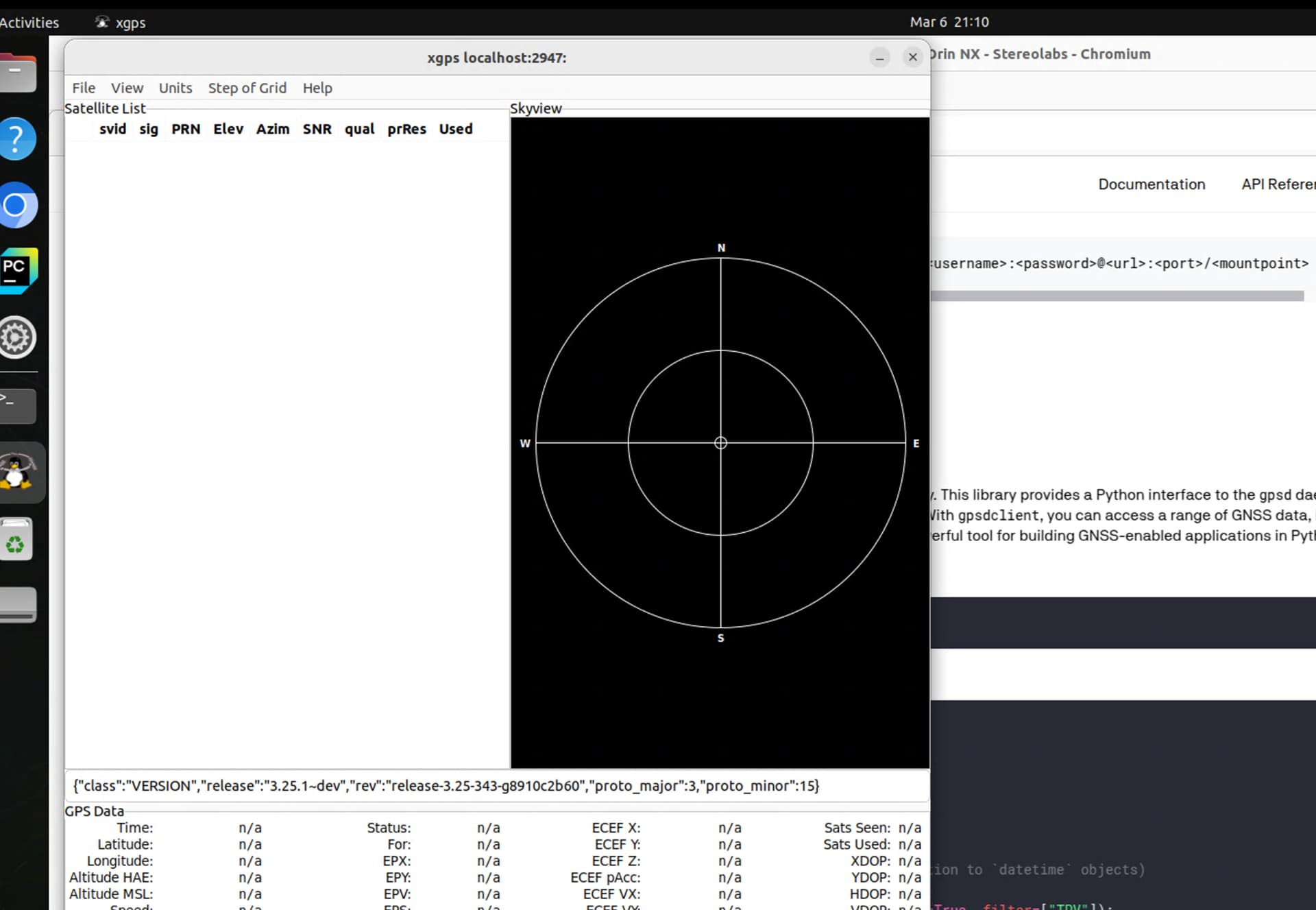

  4. Ran xgps , but no GNSS data was displayed.
  5. Cross-checked system timestamp settings, and they appear to be correct.
Issue Observed:
Expected Outcome:
  • Running cat /dev/ttyACM0 should display GNSS data output.
  • xgps should show the satellite fix and GNSS data.

You may need to nuke the systemd controlled gpsd service first.
My memory is foggy on it, but I encountered the same issue, where the gpsd socket was being controlled by a non-functional instance of gpsd, and preventing me from launching it properly.

My knowledge of systemd is minimal, but through some research, I learned that it is useful for parallel service startup. It seems that creating another user on the system caused this issue. After removing that user and running the following commands, followed by a system restart, the GPS service started working successfully:
sudo systemctl stop gpsd.socket
sudo systemctl stop gpsd.service
sudo systemctl disable gpsd.socket
sudo systemctl disable gpsd.service
I’d like to understand—did creating another user cause this issue? I haven’t installed or modified systemd directly, so I’m trying to pinpoint the exact reason behind this behavior.
