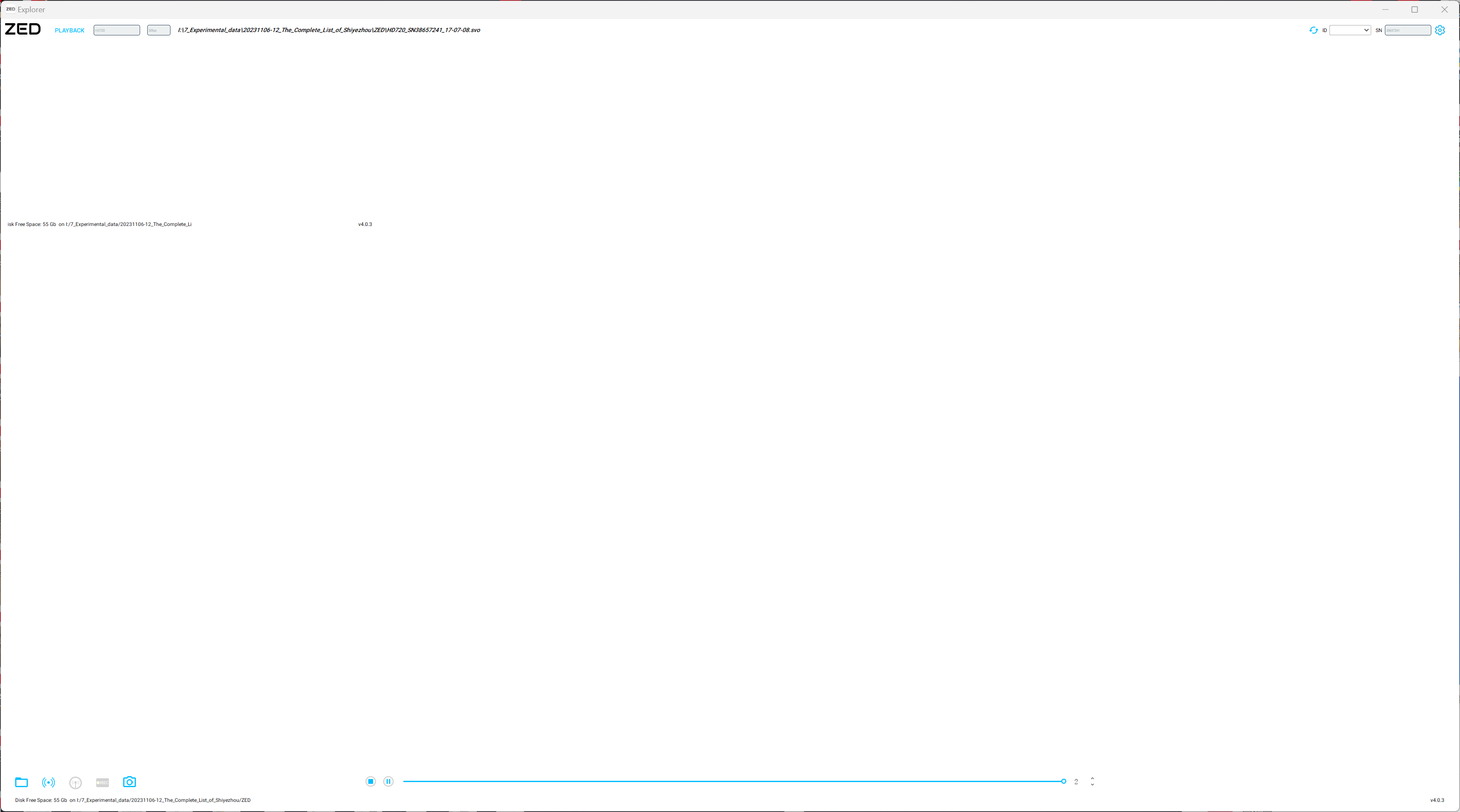

Is there any way to fix the svo I recorded with zed?
I have recorded several svo videos with zed 2i, the svo video itself is 5.48GB, but when I open this video again with zed explorer, it keeps showing a white screen, and the progress bar underneath jumps back and forth between 0 and 2, this data is very important to me and it’s almost hard to get access to it again, is there any way I can fix this video? Is there any way to fix this video? Or is there any way to get the image out of this video?
Hi @ZZC
did you try to use the $ ZED_SVO_Editor -repair <input.svo> command?
Get more information with $ ZED_SVO_Editor --help.
Thank you very much for your suggestions. I have successfully repaired the corresponding video. I once again express my heartfelt gratitude, thank you!
