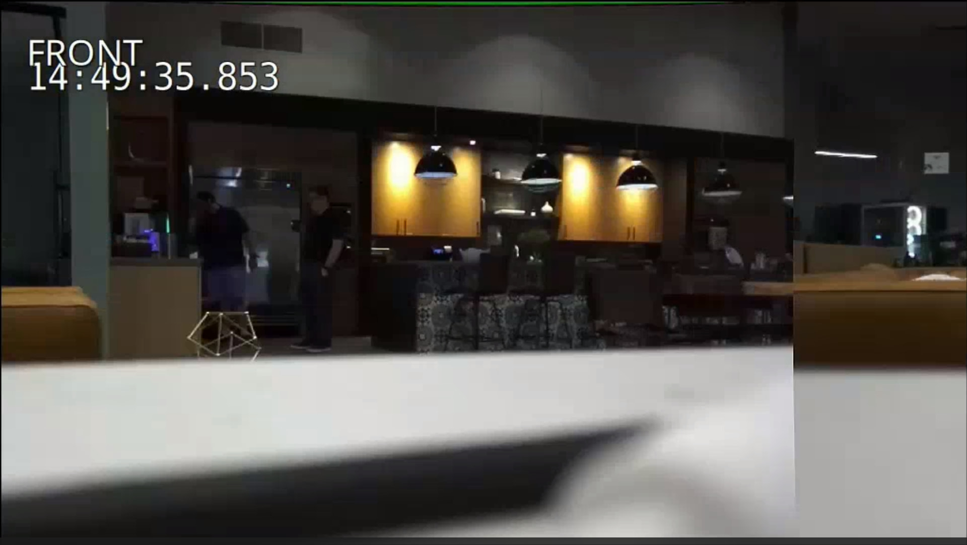

I am experiencing an intermittent issue with our ZED2i camera feed where the left and right halves of the video frame appear to be swapped or flipped. The image added is of the left camera frame but it occurs on both.

Details: The glitch occurs sporadically during operation. The video feed will suddenly show the left side of the image on the right, and vice versa. It seems like a frame buffer synchronization or UVC/USB packet handling error under this specific environment. This can be seen in ZED Explorer as well.

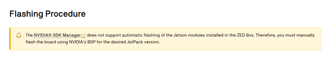

To clarify the setup: we flashed the ZED Box Mini with JetPack 7.2 using NVIDIA’s standard flashing tools because our software stack requires Ubuntu 24.04. Since the ZED SDK 5.4 installer for JetPack 7.2 was available on the website, we assumed the SDK was ready for this OS combination as long as we stuck to the standard USB interface (since GMSL drivers aren’t supported yet).

This procedure is not supported with the ZED Box Mini, as explained clearly in the documentation:
