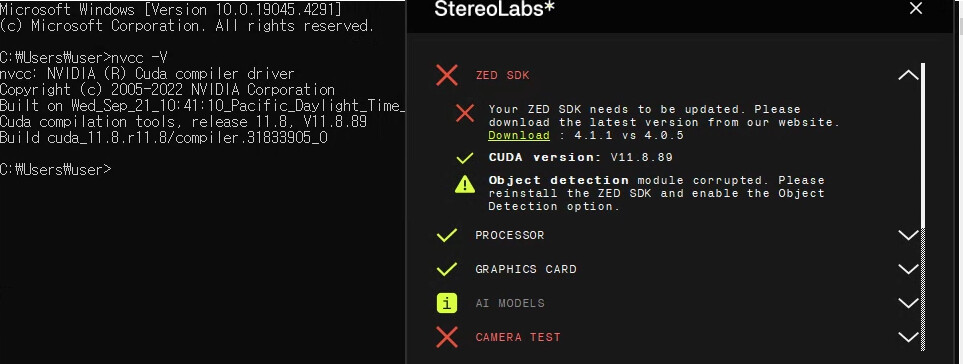

I changed to the ZED sdk 4.1 and got svo2 through ZED explorer, but when I tried to run depth viewer, it didn’t work. (I got an error about could not find procedure entry point DLL).
I checked Diagnsitic and got the following results.
I was wondering how to get SDK 4.1 to work.(I aleardy down SDK 4.1 and check the cuda version)

According to the information of the diagnostic report you did not install the new SDK, but you are using an old v4.0.5.
Please uninstall all the installed versions, and download the latest v4.1.1 for CUDA 11, and retry.
