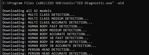

  1. It’s not very straightforward, but you can install the same ZED SDK Version on a PC connected to the internet (it doesn’t have to have a nvidia GPU), or download a Docker image. You can skip the installation of the optional elements; you will only need the ZED Diagnostic tool.
Then run the tool with “-aid” option to download all the AI models for this ZED SDK Version.
$ ZED_Diagnostic -aid
On Linux the model will be in /usr/local/zed/resources/ you can transfer them on the Jetson. (On Windows C:/ProgramData/Stereolabs/resources/)

Thanks for the help. I got the SDK for windows on a connected machine, and now I’m trying to run the diagnostic tool with that ‘-aid’ flag. I can get it to run from powershell without the flag, but when I include -aid, it just doesn’t run. I tried with and without quote marks. Perhaps there’s a different flag for windows vs linux systems?
Can you try with CMD and not PowerShell?
I just tried it, unfortunately it does the same thing. I also tried using the ‘start’ command instead, that opens a window but it immediately closes and nothing further happens. Once again if I leave out the -aid tag, the diagnostic tool opens without issue.
I have no issue when I do it on my side
Are you on Windows 10 or 11 ? I don’t think it matters but who knows?
Fascinating… I’m on Windows 11 enterprise. Do you think it could be because I don’t have CUDA or a graphics card?
Yes I’m sorry about that, turns out in the current version you need CUDA even to download models, not directly in the tool but in the underlying libs.
