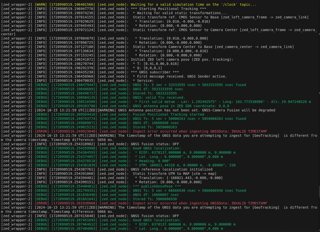

The recent update to SDK 4.0.5 seems to have resolved this issue
I am getting the same issue, but i am using the latest ZED SDK 4.2. I verified the ros2 topics of /clock and /gps/fix and the timestamps are perfectly in sync. I am not sure where the issue is from.
