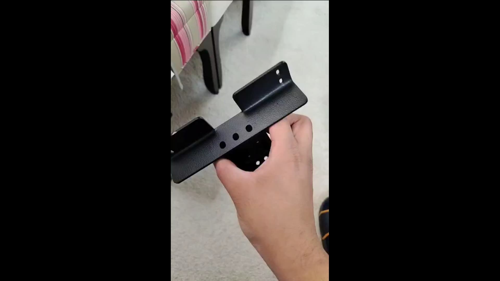

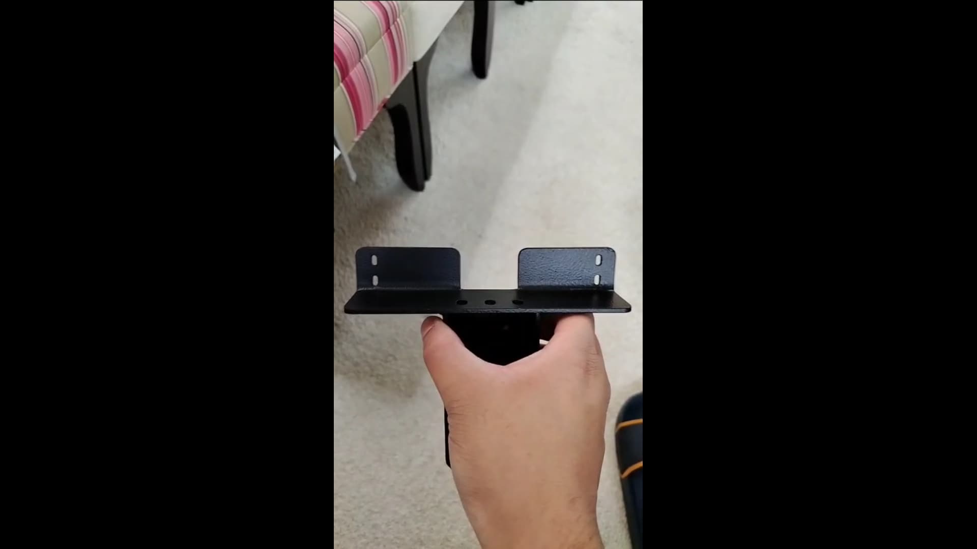

Please send a picture of your metal mount.
Is it forcing the structure of the camera, causing a misalignment of the optics?
Yeah , this how the mount is
The mount seems good to me. Are the fixing holes placed correctly?
They must be precise in order to not modify the case structure of the camera…
Yes, they are precision-cut with a slotted design, so they definitely don’t alter the structure. Additionally, one of the cameras became miscalibrated simply from being used handheld near the mount, without actually being mounted.
As I mentioned earlier, the same structure doesn’t cause any issues with my 3D-printed version, but problems arise when using the metal one. Could you please look into this? More than three of my cameras have shown inaccurate behavior with this metal mount.
