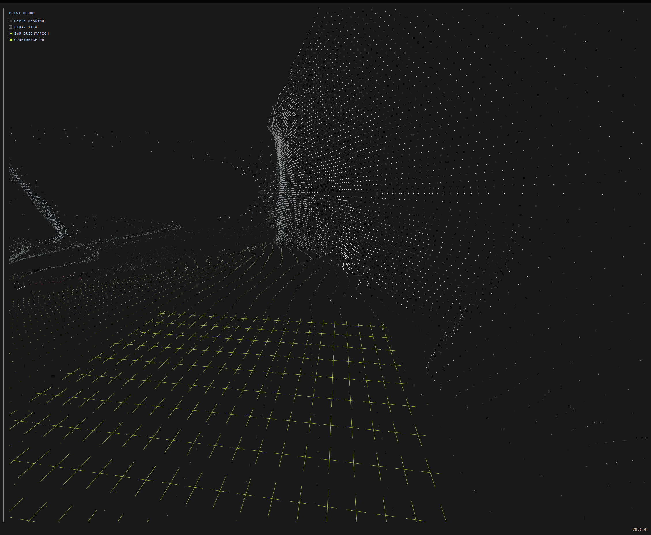

We have observed that certain objects, although clearly visible in the 2D image, appear poorly reconstructed in the 3D point cloud — particularly in terms of shape and depth consistency.

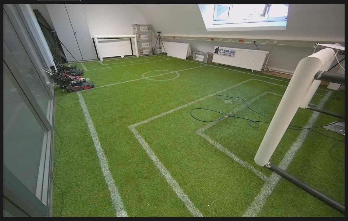

I am working on detecting a ball on a field with reduced dimensions. The field is 6 meters by 4 meters, and the ball has a diameter of approximately 15 cm. First, I perform ball detection, and then I obtain the distance to the ball from the depth map using zed.retrieve_measure(depth_zed, sl.MEASURE.DEPTH) followed by the function depth_zed.get_value(x, y)[1] on the pixel at the center of the ball. However, this is where the problem arises: the measured distances are not accurate enough (nearly 10% error at 6 meters), and the error becomes even more significant as the ball moves away from the center of the image.

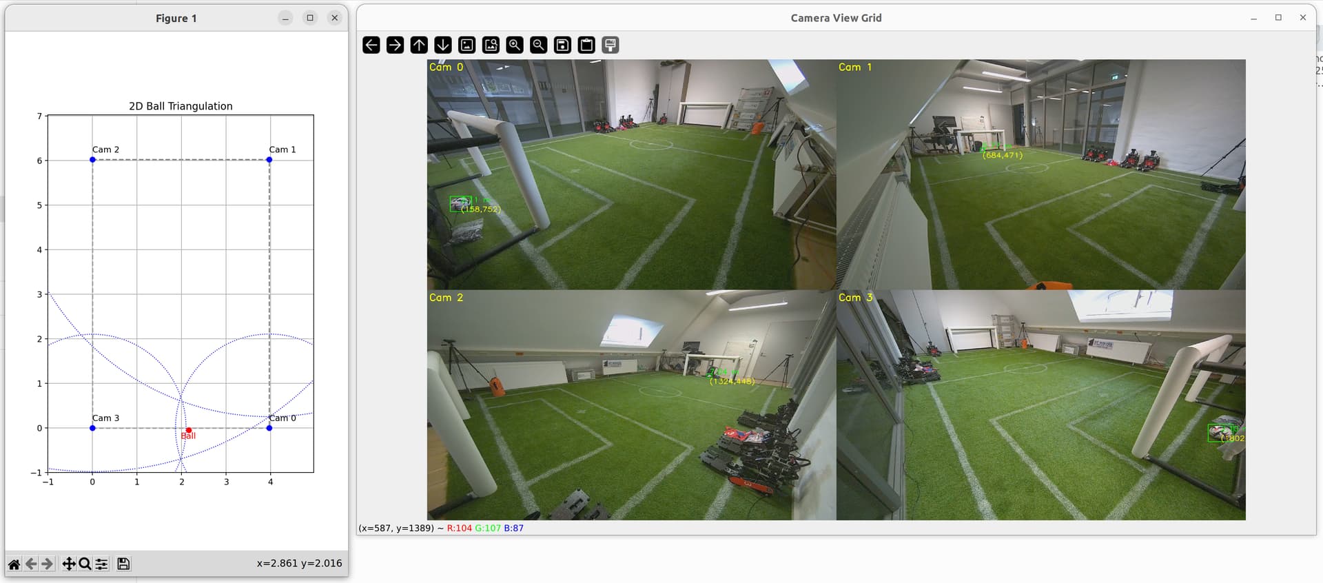

Hello, first of all, thank you for the advice. Now, I am taking into account the central point and its neighbors to avoid measurement noise, and I am using the function you recommended to measure the distance. However, despite some improvements, the results remain unsatisfactory. Here is an example of my display, which aims to determine the position of the ball based on the distance to the four cameras in the corners. Ideally, the four circles should intersect at a single point, but we are still far from that. We even performed a factory reset on each camera, but it didn’t change much. So, I am reaching out to you again in hopes of a solution.
