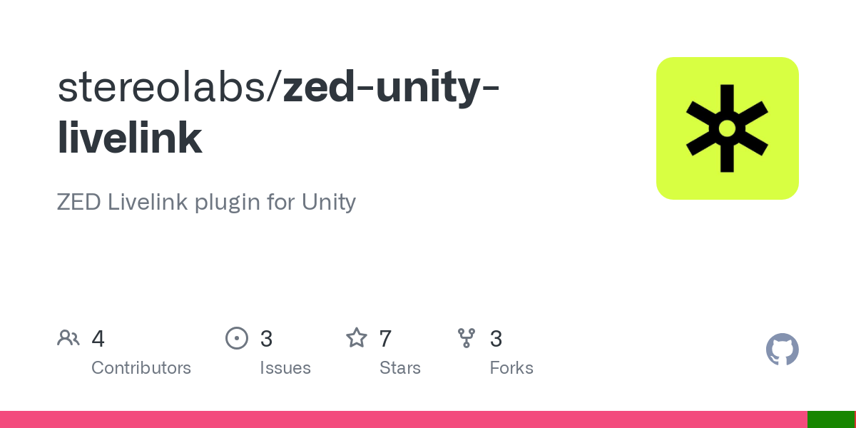

I found now the right source:
i also compiled it and the fusion is now kinda working.

I also answer this question by myself, for all after me with not so much experiences in this stuff.
How i got Fusion working on windows with SDK 5.0.1
  1. Use this source in Cmake: from github - stereolabs/zed-unity-livelink
  2. follow the Cmake tutorial but use paths to the zed-unity-livelink. only the how to make the visual studio solution → stereolabs website /docs/app-development/csharp/use
  3. use latest visual studio community (with unity)
  4. once you compiled the first (release) build try optimizing, the zed-unity-livelink has old settings within: “senderRunner.cpp” replace them with the new settings: stereolabs website /docs/depth-sensing/depth-settings
  5. recalibrate your ZED cam with neural as in the senderRunner.cpp
  6. if not yet train all AI models
  7. if you get the Unable to subscribe to [cam ID]. MEMORY ALREADY USED error your cable is almost certain the problem. If you have an original zed cable with this error it is broken. And if you use fiber cable like me, be sure the Cable plus ist perfectly stable and secure in the cam or it will fail!
cheers
