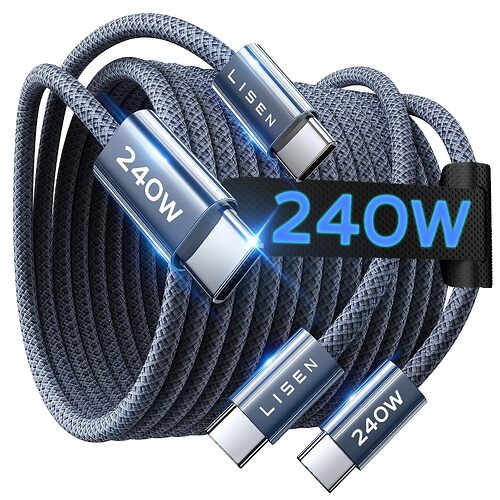

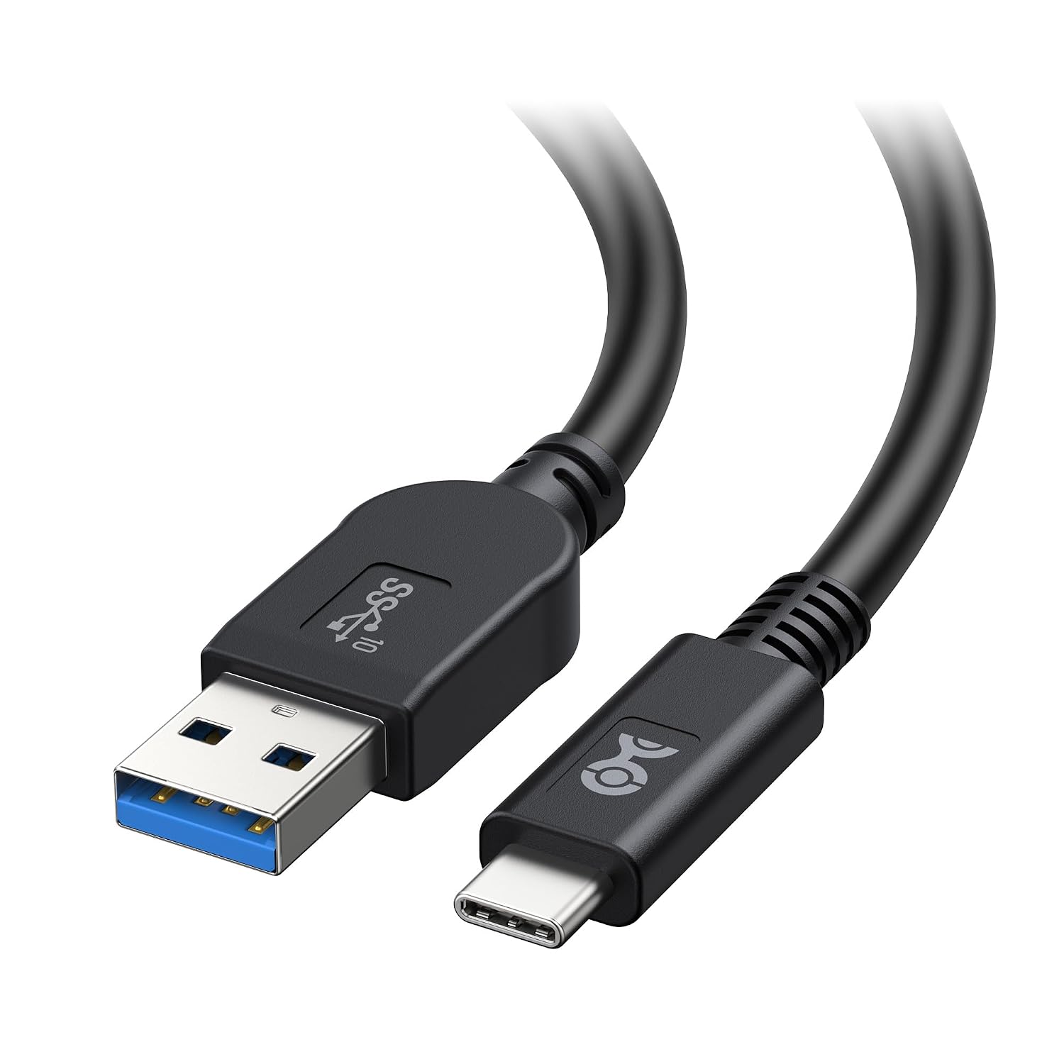

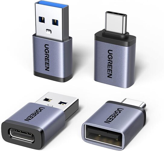

These were the cables I bought to test, as mine didn’t come with a cable that I saw

I’ve tried multiple cords, multiple directions, hub, no hub nothing ever connects.
I never got a usb cable with my camera on my order also, but i bought these, none of which worked in any order or combo, hub, no hub, adapter no adapter. I’ve been trying to get this to work for a month.
this is the last cable i tried as well, also didn’t work i still get the same thing every pc i try and every direction
LISEN USB C to USB C Cable, 240W Fast Charging Type C Charger Cord (6.6FT)
it wont let me post a link ti keeps flagging me

The Cable Matters USB-IF certified cable is a valid USB 3 cable, so with the camera connected directly to a blue USB 3 port of the Raspberry Pi 5 the video interface should enumerate on the 5000M bus. If it never appears with that cable, on three different hosts and in both connector orientations, the cable and the hosts are no longer the likely cause; this points to a fault on the camera side, such as the USB-C connector or the SuperSpeed interface of the ZED Mini.
Please note that the LISEN USB-C to USB-C cable is a charging cable that carries only USB 2 data, and the UGREEN adapters add a further point of failure, so they are not useful for this test.
As a last check, please connect the camera directly to a blue port of the Raspberry Pi 5 using the Cable Matters cable, run the following command before plugging it in, and post the full output:
sudo dmesg -w
followed by:
lsusb -t
A healthy ZED Mini shows a new SuperSpeed USB device line for the video interface; any USB 3 link error reported by the kernel will confirm the diagnosis.
