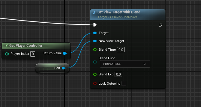

Why can’t we trigger the ZED using Blueprint when nDisplay is launched (Event BeginPlay)? I think this might solve our problem. Is there any Blueprint to start the ZED?
Can you try to do something like this?
