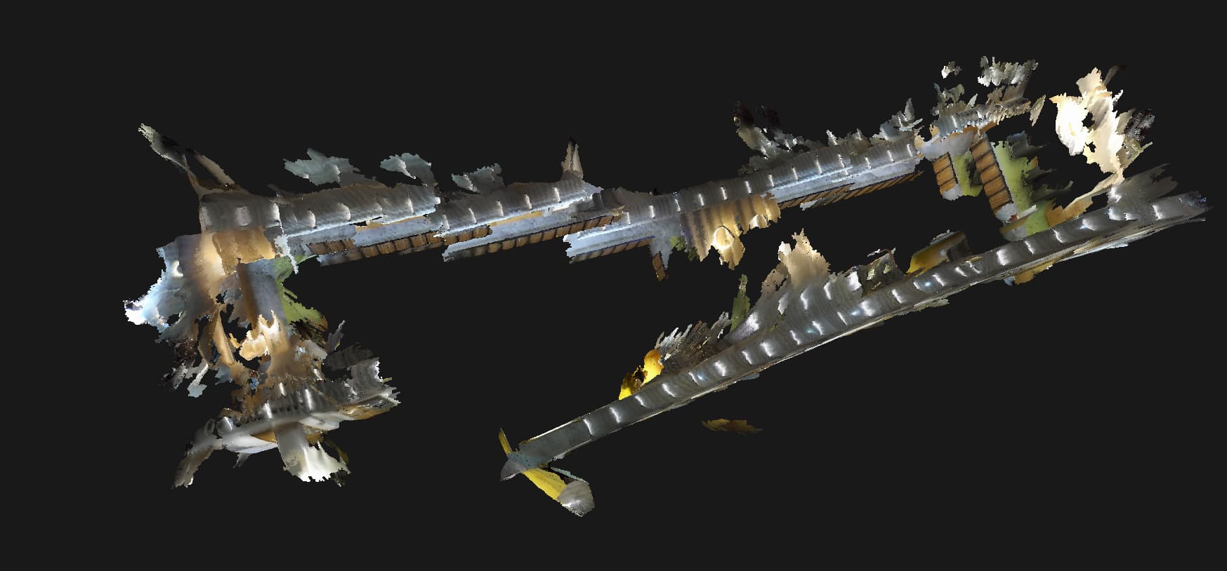

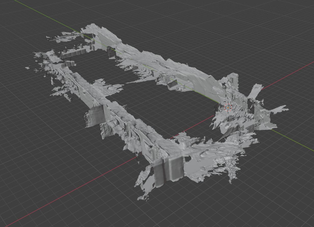

I am currently working with a ZED 2i camera and using ZEDfu to generate 3D environment reconstructions. I export the map as an OBJ file together with the MTL and PNG texture. When I view the file in ZEDfu, the details and colors look correct. However, when I load the OBJ into Blender, many details appear missing or simplified compared to what I see in ZEDfu.

You should ask to Blender support, providing the OBJ file to analyze it.
