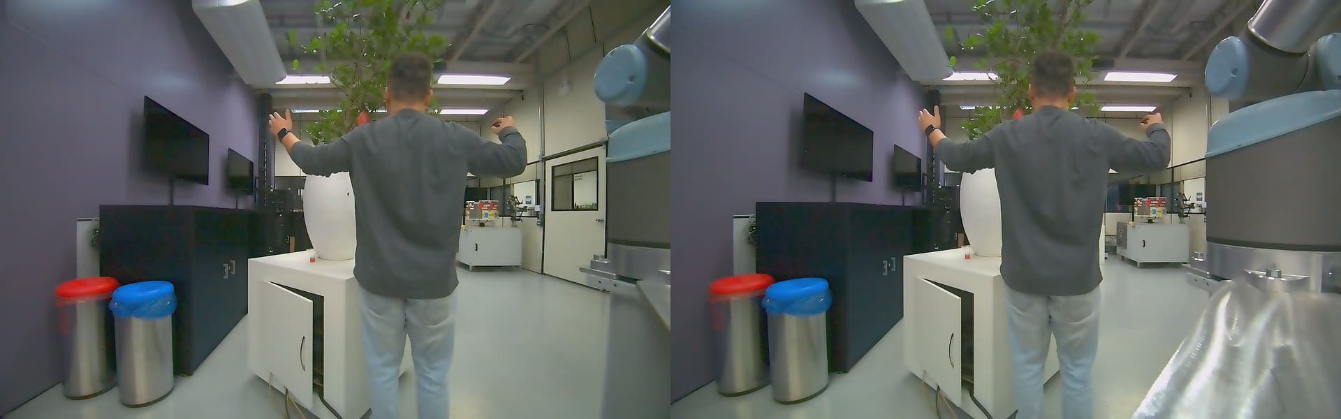

I noticed that my ZED X camera image looks very blurry, as you can see in the image below.
  • Is this expected behavior, or could it be a focus issue?
  • Is there any method or recommended adjustment to reduce the blur?
Any suggestions on how to solve this would be greatly appreciated.

This is not expected, this might be because of a known issue in the ISP, this issue should be fixed though. Can you share the output of the drivers installation ? sudo dpkg -i stereolabs-zedbox-mini 1.3.1-SL-MAX9296-all-ZEDBOX-MINI-L4T36.4.0 arm64.deb > log.txt

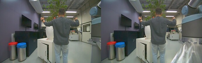

Thank you, can you run:
sudo apt install nginx
ar x stereolabs-zedbox-mini_1.3.1-SL-MAX9296-all-ZEDBOX-MINI-L4T36.4.0_arm64.deb
tar xvf data.tar.xz
sudo cp ./tmp/R36.4.3/libnvisppg.so /usr/lib/aarch64-linux-gnu/tegra/libnvisppg.so
reboot
This will update the isp library and should solve your issue
Thank you, this is much much better!
