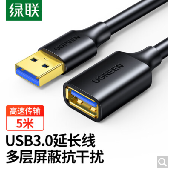

UGREEN USB3.0 extension cable,5m.
Signal transmission may weaken or be lost.
I would like to know what good cables can ensure data transmission efficiency and ensure that image resolution does not decrease. Thank you!
We advise you to use active USB3 extenders for this cable length.
