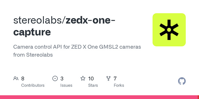

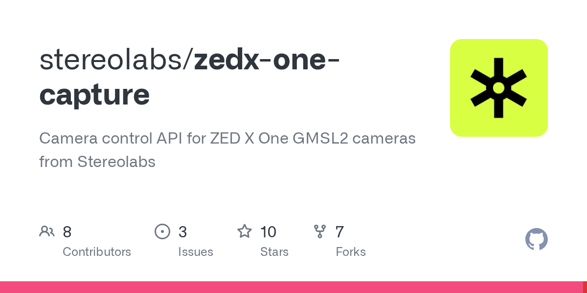

Hi @TerryL-TongjiU
Unfortunately, the ZED SDK does not provide this feature.
You could try to use the code in this repository:
Look at the ArgusBayerCapture.cpp code.
