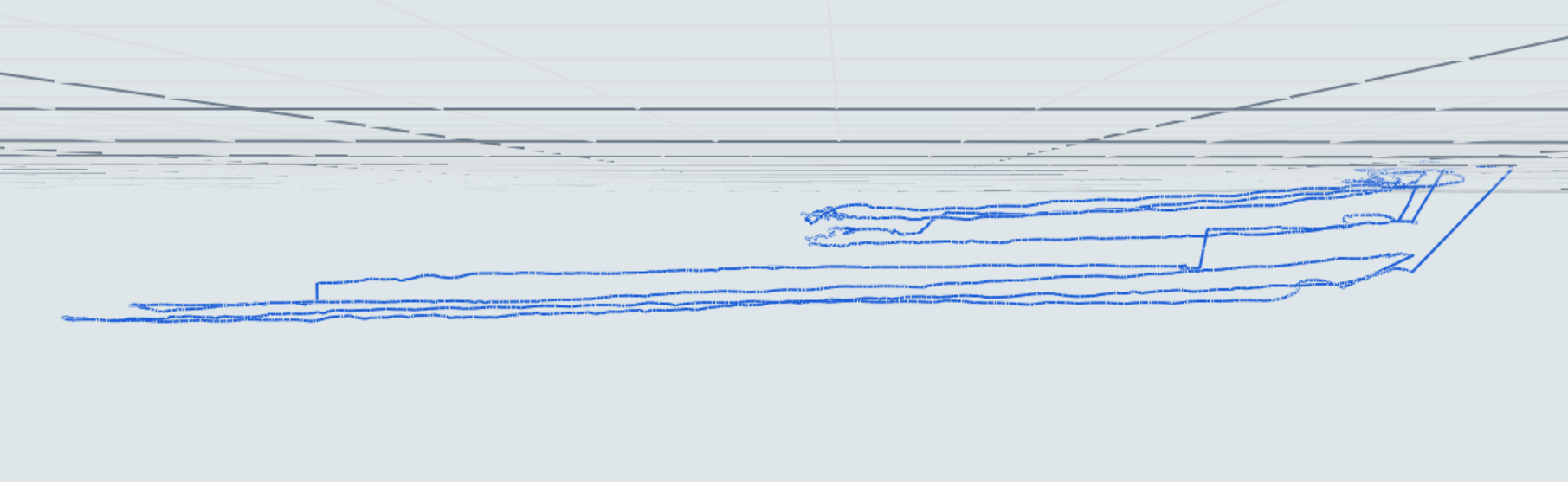

I am using the positional tracking function as ground truth to make RGB-pose dataset. If enable_area_memory: true, when the place that has been walked is detected, the pose will correct the drift but there will be a big jump.
I have tried to move around the field repeatedly to stabilize the pose, then save the map to .area, and then import the .area to relocate in the environment, but the effect was not good and there was more pose jumping.
I also tried enable_pose_smoothing: true but it didn’t help much.

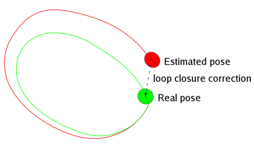

I would like to ask if there is any way to achieve pose alignment and shared error to optimize and correct the entire trajectory after loop closure, similar to the effect of the ORB-SLAM method etc.
the complete trajectory after global optimization can be obtained.
This is important to me because I want to use it as an offline dataset.

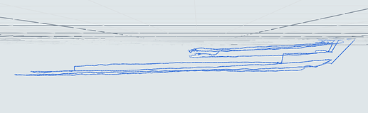

:This is one of the results of my operation. I always take the same height and walk back and forth. I hope to get the entire corrected trajectory and the corresponding image. Currently, I store the image and pose frame by frame.
This is an expected behavior if the path drifts during camera movements.
This feature is not available.
You can try to improve the positional tracking behaviors by using the ULTRA depth mode and by setting the positional tracking mode to sl::POSITIONAL_TRACKING_MODE::QUALITY
