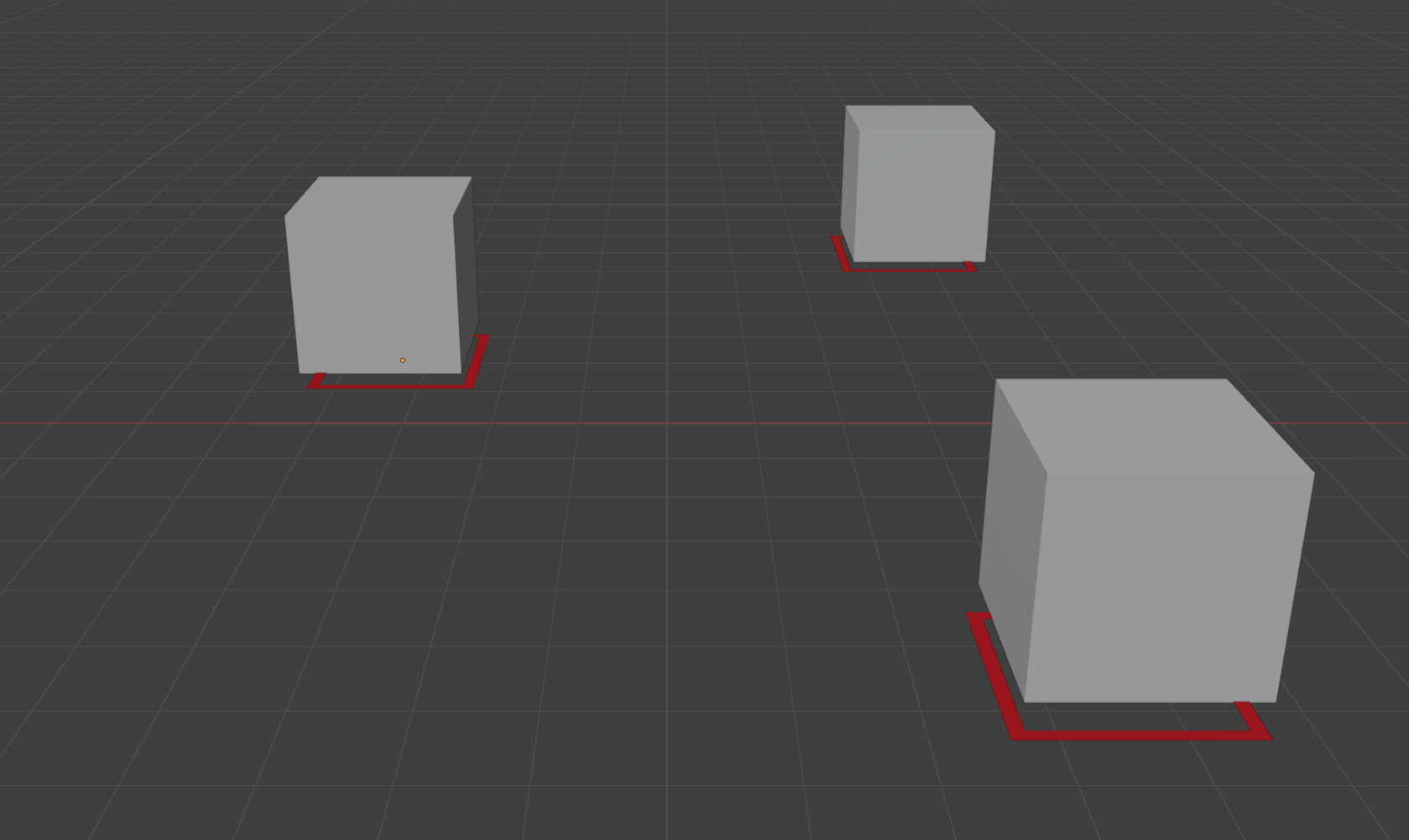

I can’t share images but this is roughly what I saw:
The red boxes are the estimated positions of the cubes, with their Y component set to the floor height.
I was seeing an offset towards the camera. That means, an object detected on the left half of the image (-X) would have its 3D position biased a bit to the right and towards the camera, and viceversa for an object on the right side of the image.
I suspect the reason is that the SDK is estimating the 3D position of the object based on either the segmentation mask of the object (and its resulting estimated depth), or the estimated depth across the whole bounding box. Either way without knowing the real geometry of the detected object, it is normal to estimate its center closer to the camera than in reality.
I am happy with the current behaviour of the position estimation, since this kind of bias can be easily accounted for with knowledge of the detected object’s geometry.

Yes, indeed you can confirm this by drawing the 3D bounding box and a point in the “position” coordinates.
