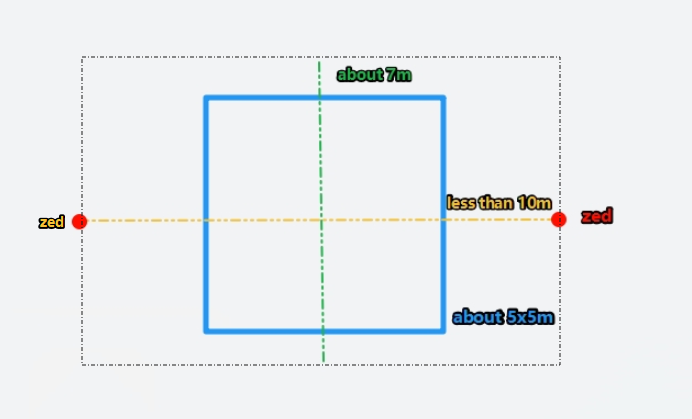

As shown in the figure, we need to film a venue with an area of 5x5 meters. Taking into account the shooting range of the cameras and the fact that we still need to conduct some tracking of people even when they are a bit beyond the 5-meter mark, the final size should not exceed 10x7 meters. The two ZED cameras must be placed facing each other (in order to obtain the front and back images of people and use a model like YOLO for segmentation and matting).

First, for an area of this size, I’d use 4 cameras, with one in each angle, that way, you cover the whole space and always have multiple cameras detecting everyone.
Then, by looking at your zed360 video, I see the body tracking quality is pretty low, especially for one of the cameras.
Are both cameras connected via USB to the same pc?
Do you know if something might have altered the body tracking module during that sequence?
