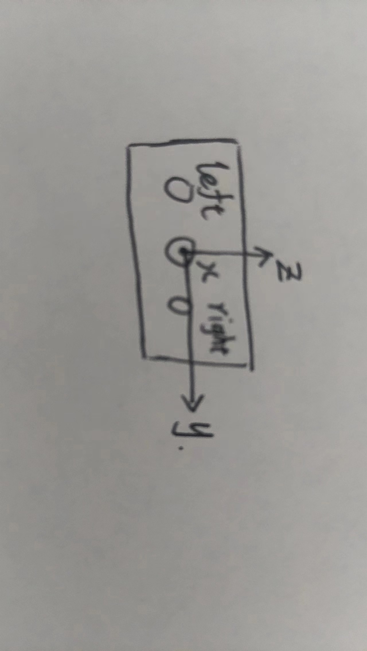

The second question is: how is the camera coordinate system of zed camera established? I used the zed data in zed_ros_wrapper package and found that the positive direction of x axis is the vertical mirror facing out, the positive direction of z axis is parallel to the mirror facing up, and the positive direction of y axis is parallel to the mirror from the left eye to the right eye. Is this coordinate axis correct? As shown in the picture below:

Regarding the camera coordinate system, if you are not using ROS, you should not look at it, but read the Stereolabs documentation.
The coordinate system reflects the setting that you use for InitParameters::coordinate_system → Core Module | API Reference | Stereolabs
