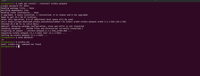

error5
This is the output and i should use remote connection

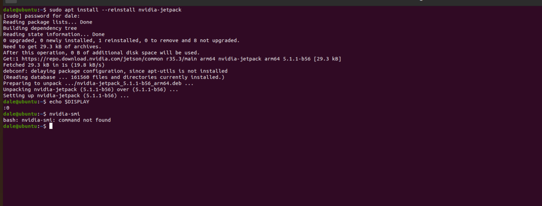

You don’t have nvidia-smimeaning CUDA and / or the nvidia driver is not installed correctly. Can you send me the exact output of
sudo apt install --reinstall nvidia-jetpack
? That must be it
still same after the reinstall.
Installing the jetpack should print a lot more lines than that. The installation probably silently failed.

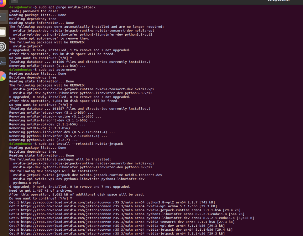

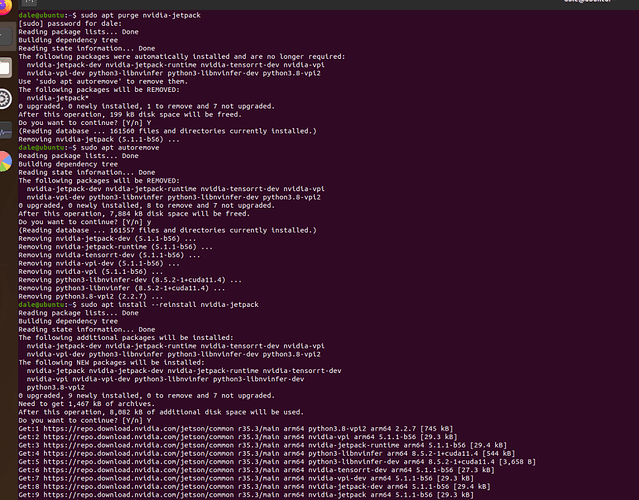

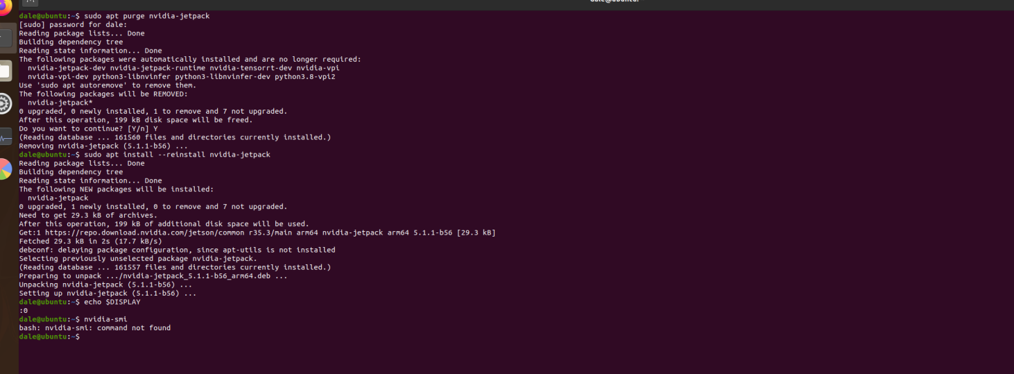

What if you run
sudo apt purge nvidia-jetpack
before ?
Hi, I tried this too but still getting command not found .
can you run
sudo apt autoremove
Right after the purge, as the log suggests ?

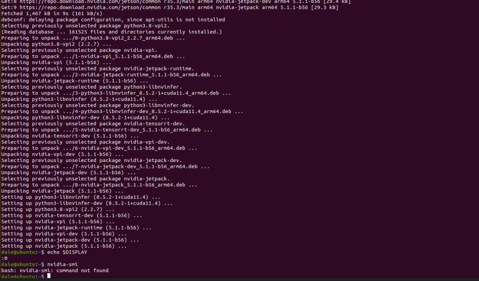

In this log the nvidia-jetpack did not reinstall again. It should download >6gb and take 15min to install.
I did this but reinstall part runned like 20 seconds and still nvidia smi responding same.
