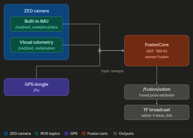

Hey everyone,
I’ve been building a ROS 2 state estimator called FusionCore and wanted to share how it integrates with ZED cameras for mobile robot setups. @Myzhar pointed me here after I opened an issue (#429) on the ZED ROS2 wrapper.
What FusionCore does?
FusionCore is a 22-state UKF that fuses IMU, wheel odometry, visual odometry, and optional GPS into a single clean odom → base_link estimate. It runs gyro and accelerometer bias estimation in the filter state, adapts its noise covariance automatically, and gates outliers with a chi-squared test per sensor.
How it works with ZED
The ZED node publishes two things FusionCore can consume directly:
  • /zed/zed_node/imu/data → FusionCore IMU input
  • /zed/zed_node/odom → FusionCore secondary odometry (encoder2.topic)
If you also have wheel encoders, those go in as the primary source and ZED visual odometry becomes the secondary. FusionCore outputs /fusion/odom (nav_msgs/Odometry) and broadcasts the odom → base_link TF at 100Hz.

TF architecture
ZED → /zed/zed_node/imu/data  ─┐
ZED → /zed/zed_node/odom      ─┤→ FusionCore → odom → base_link TF
Wheels → /odom/wheels         ─┘              → /fusion/odom
SLAM (rtabmap, slam_toolbox)  → map → odom TF
FusionCore sits underneath your SLAM stack. They don’t conflict.

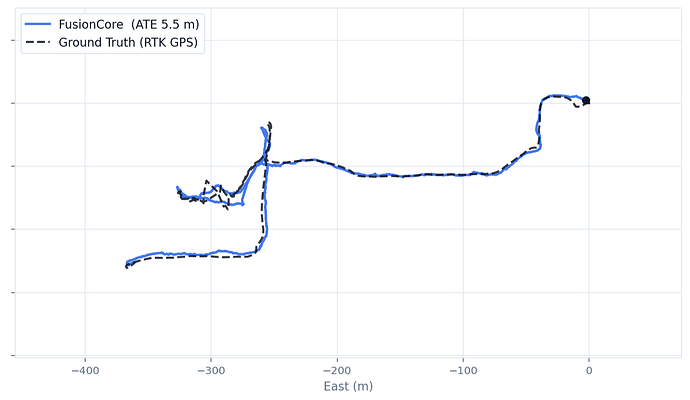

Trajectory
Where it helps most with ZED
ZED visual odometry is excellent but can drift briefly during fast rotation, low-texture scenes, or lighting transitions. FusionCore bridges those gaps using IMU dead-reckoning and wheel encoder velocity. The result is an odometry signal that doesn’t stutter when the camera loses tracking momentarily.
