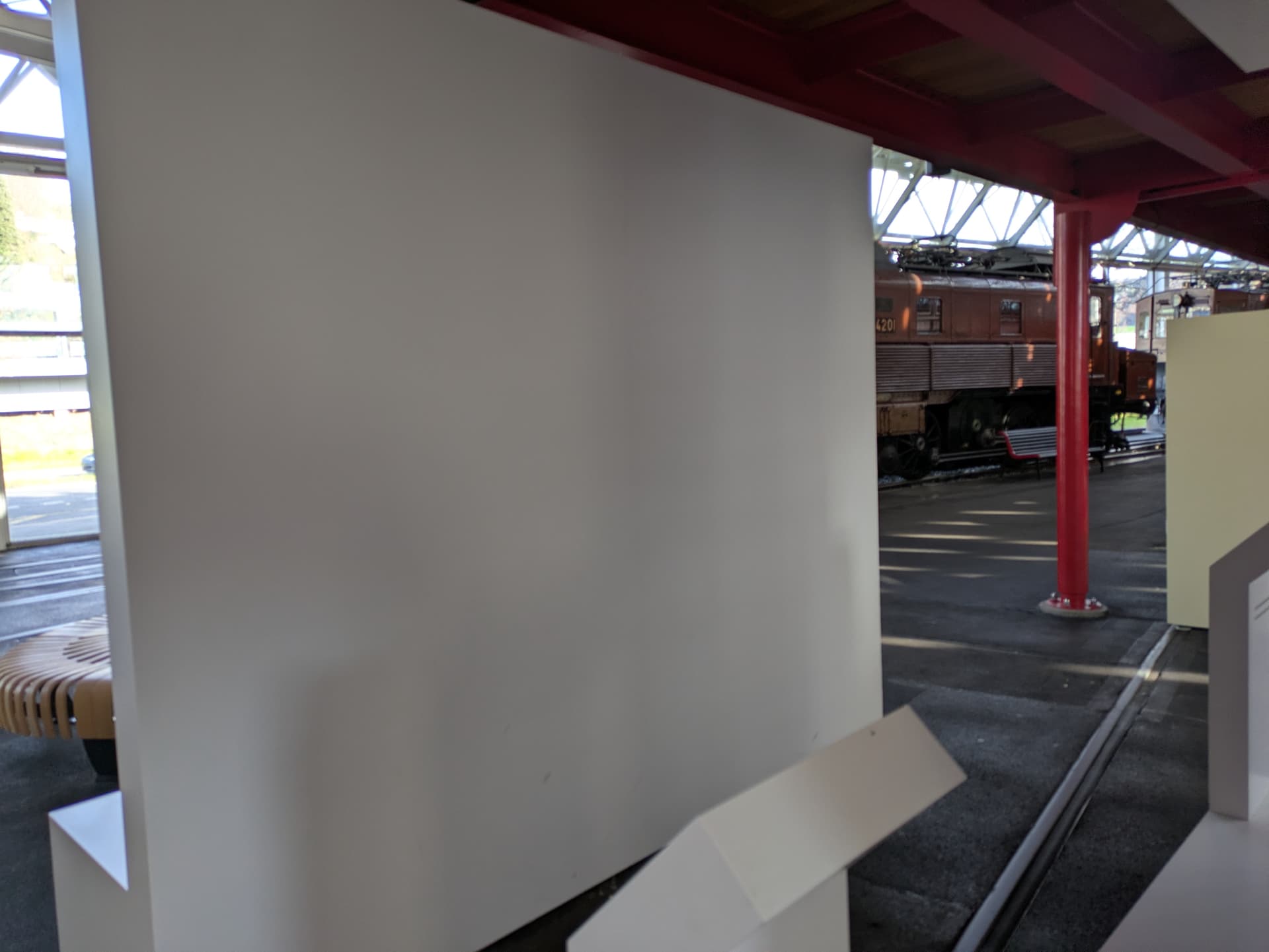

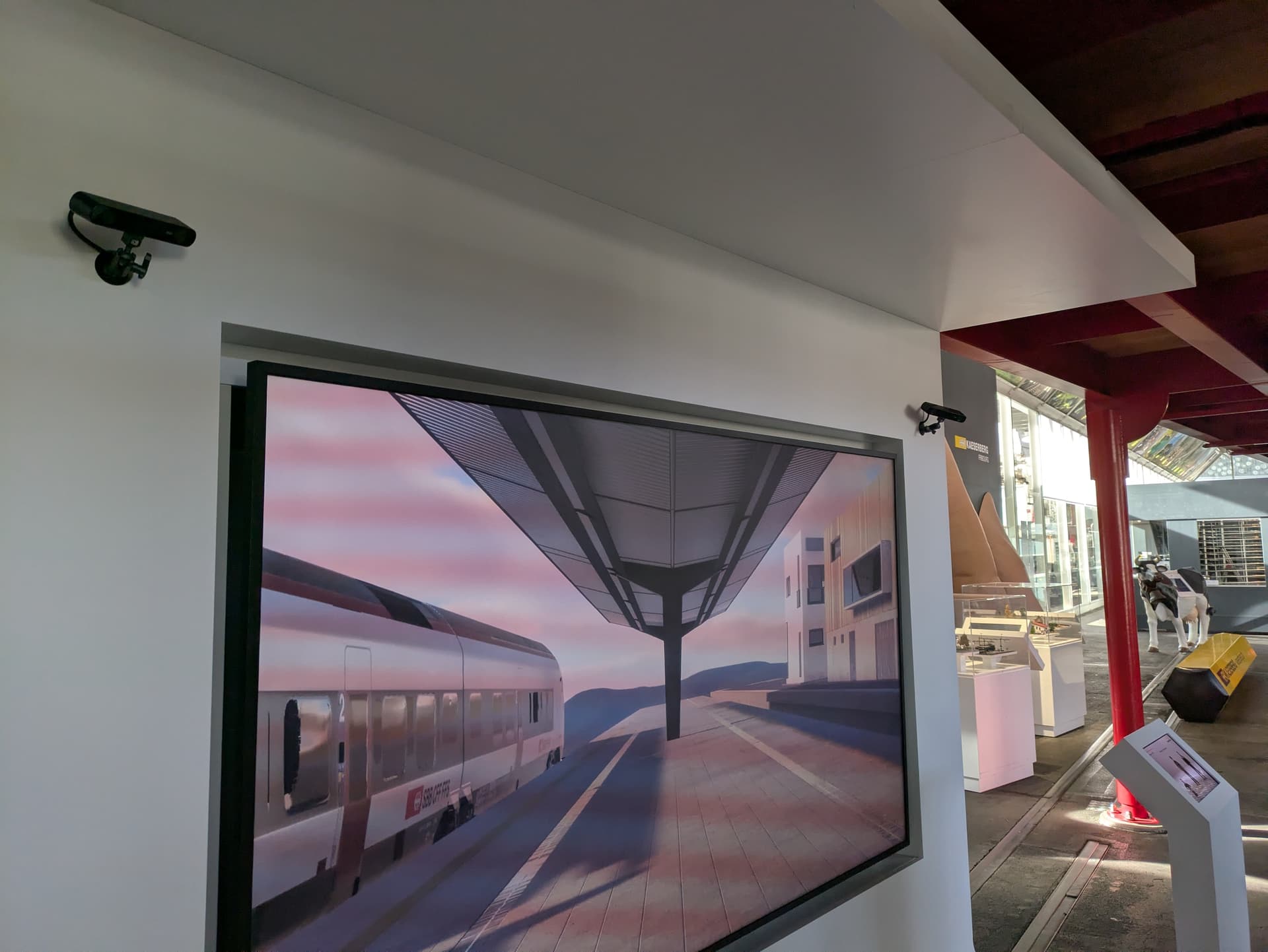

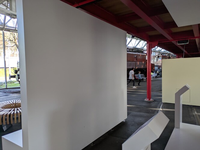

we have been using the Fusion setup with 2 cameras for some months now and since a few days even after a clean calibration the fusion starts doing wild errors.
Is it possible that the back wall of the Installation (pure White) is a problem for the cameras?
The backdrop gets direct sunlight since a few days or weeks and since then the fusion is creeping around very badly.
Is there any way we can fix this, without changing the installation?
the installation is in a museum and therefore its important that it runns stable.
This is a possible cause of the problem. Can you share pictures showing this particular condition?

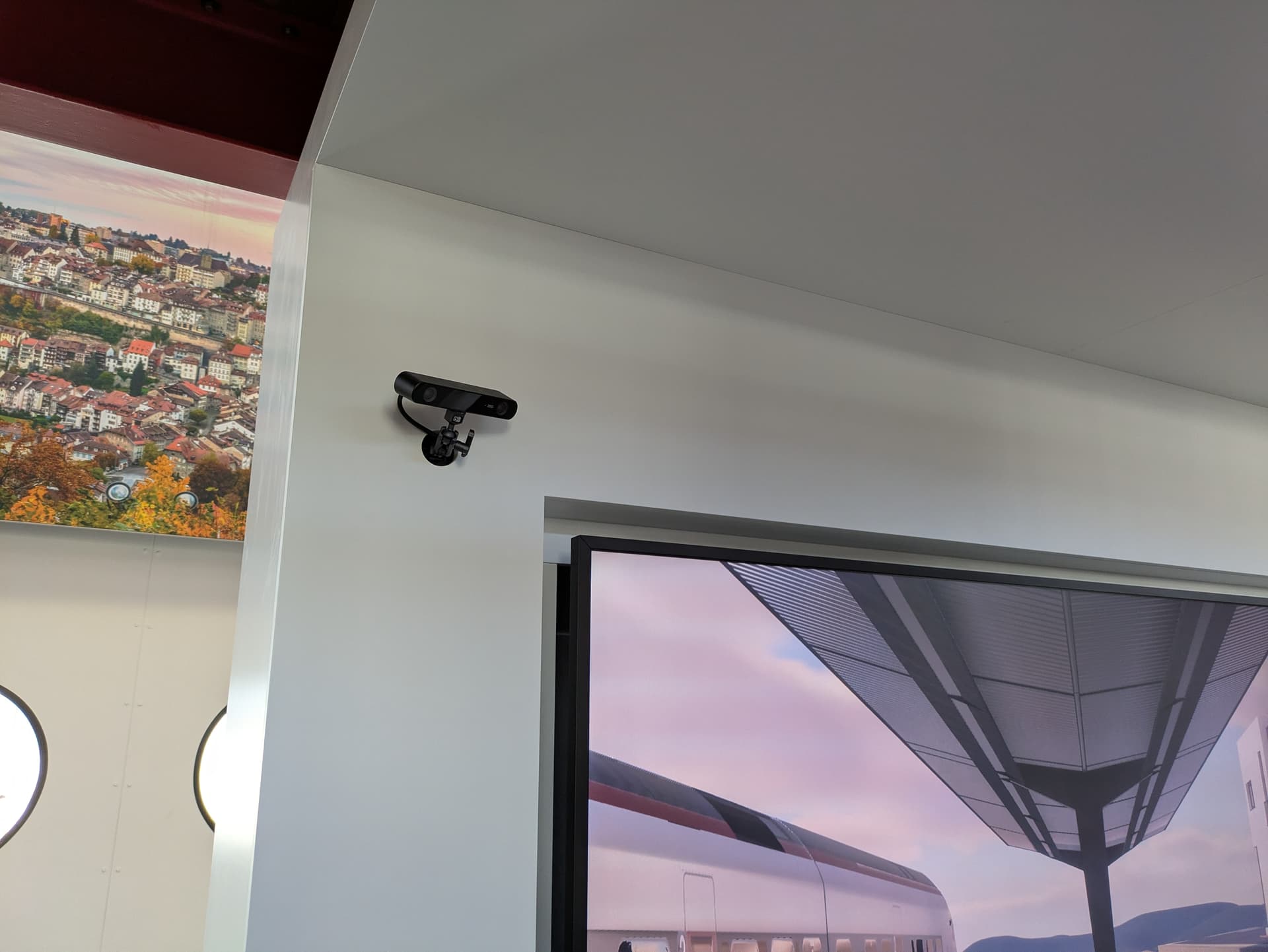

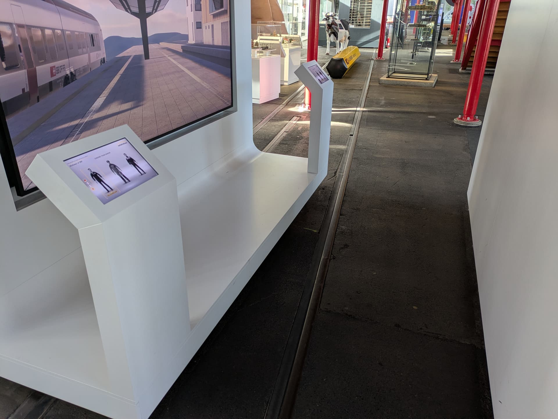

I made you pictures.
  • since the morning the direct sunlight is now gone, however the fusion still creeps around just differently.
the images:
im 100% certain this is something new, because we had it running and it worked so well.
