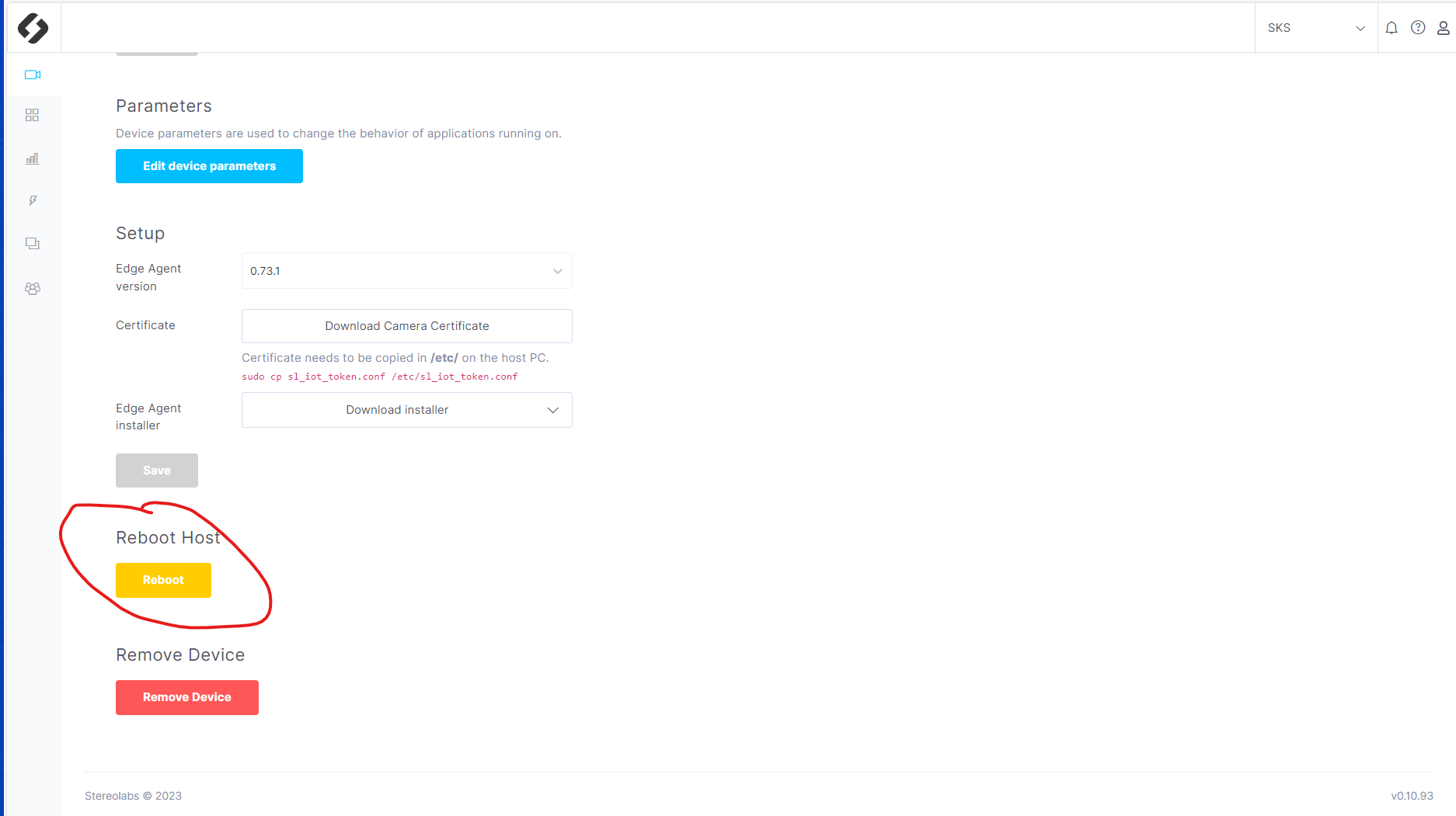

Not sure if that would help, as even if I stop the application and reboot the camera through the hub, I still get the error.
It will. Stopping the application does not reset your USB capabilities. For that you need to power cycle the device (unplug / replug), or run sl::Camera::reboot()
Won’t sl::Camera::reboot do the same as hitting the reboot button in the hub? Because that does not help unfortunately.
No, it’s not the same. And sl::rebootCamera will be even better in 4.0.8.
