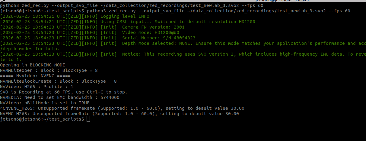

FPS not set correctly while recording SVO
Hi, I am using the below script to record an SVO with my ZED X

import sys
import pyzed.sl as sl
from signal import signal, SIGINT
import argparse
import os
cam = sl.Camera()
#Handler to deal with CTRL+C properly
def handler(signal_received, frame):
cam.disable_recording()
cam.close()
sys.exit(0)
signal(SIGINT, handler)
def main(opt):
init = sl.InitParameters()
init.depth_mode = sl.DEPTH_MODE.NONE # Set configuration parameters for the ZED
init.camera_fps = opt.fps # Set the framerate from argument
init.async_image_retrieval = False; # This parameter can be used to record SVO in camera FPS even if the grab loop is running at a lower FPS (due to compute for ex.)
status = cam.open(init)
if status > sl.ERROR_CODE.SUCCESS:
    print("Camera Open", status, "Exit program.")
    exit(1)
recording_param = sl.RecordingParameters(opt.output_svo_file, sl.SVO_COMPRESSION_MODE.H265) # Enable recording with the filename specified in argument
err = cam.enable_recording(recording_param)
    print("Recording ZED : ", err)
    exit(1)
runtime = sl.RuntimeParameters()
print(f"SVO is Recording at {opt.fps} FPS, use Ctrl-C to stop.") # Start recording SVO, stop with Ctrl-C command
frames_recorded = 0
while True:
    if cam.grab(runtime) <= sl.ERROR_CODE.SUCCESS : # Check that a new image is successfully acquired
        frames_recorded += 1
        print("Frame count: " + str(frames_recorded), end="\r")
if name == “main”:
parser = argparse.ArgumentParser()
parser.add_argument(‘–output_svo_file’, type=str, help=‘Path to the SVO file that will be written’, required=True)
parser.add_argument(‘–fps’, type=int, help=‘Camera framerate (e.g. 15, 30, 60, 100)’, default=30)
opt = parser.parse_args()
if not opt.output_svo_file.endswith((“.svo”, “.svo2”)):
print("–output_svo_file parameter should be a .svo file but is not : ", opt.output_svo_file, “Exit program.”)
exit()
main(opt)

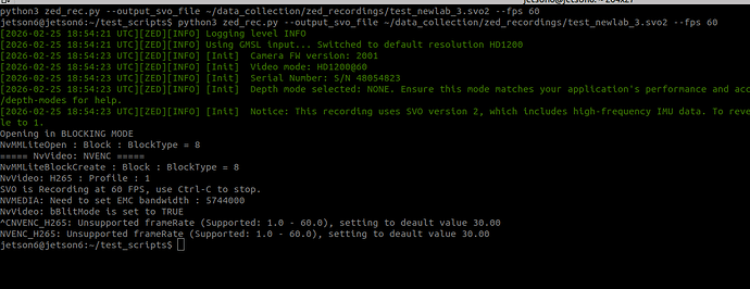

But it still records at 30 fps as seen in the log below.
This problem has been fixed with the most recent versions of the ZED SDK
Hi, I am currently using the latest ZED SDK, version 5.2.0. Were you referring to an unreleased version? If yes, do you have any estimate for when the next release will be available?
Thanks!
I reported the new bug to the SDK team to fix it as soon as possible
when the grab rate is 60hz, does position tracking consume images at 60 Hz? or it cosumes at some max frequency regardless of high grab rate? I am willing to understand if its worth it to downgrade to collect a 60 FPS svo or not.
Yes, it works at the grab rate.
