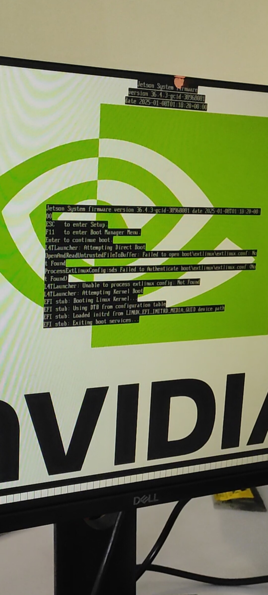

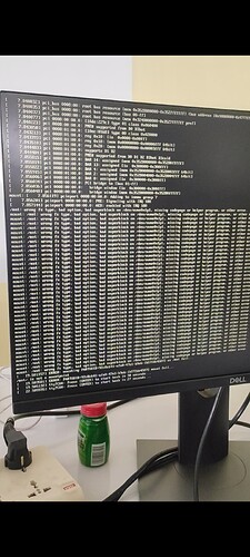

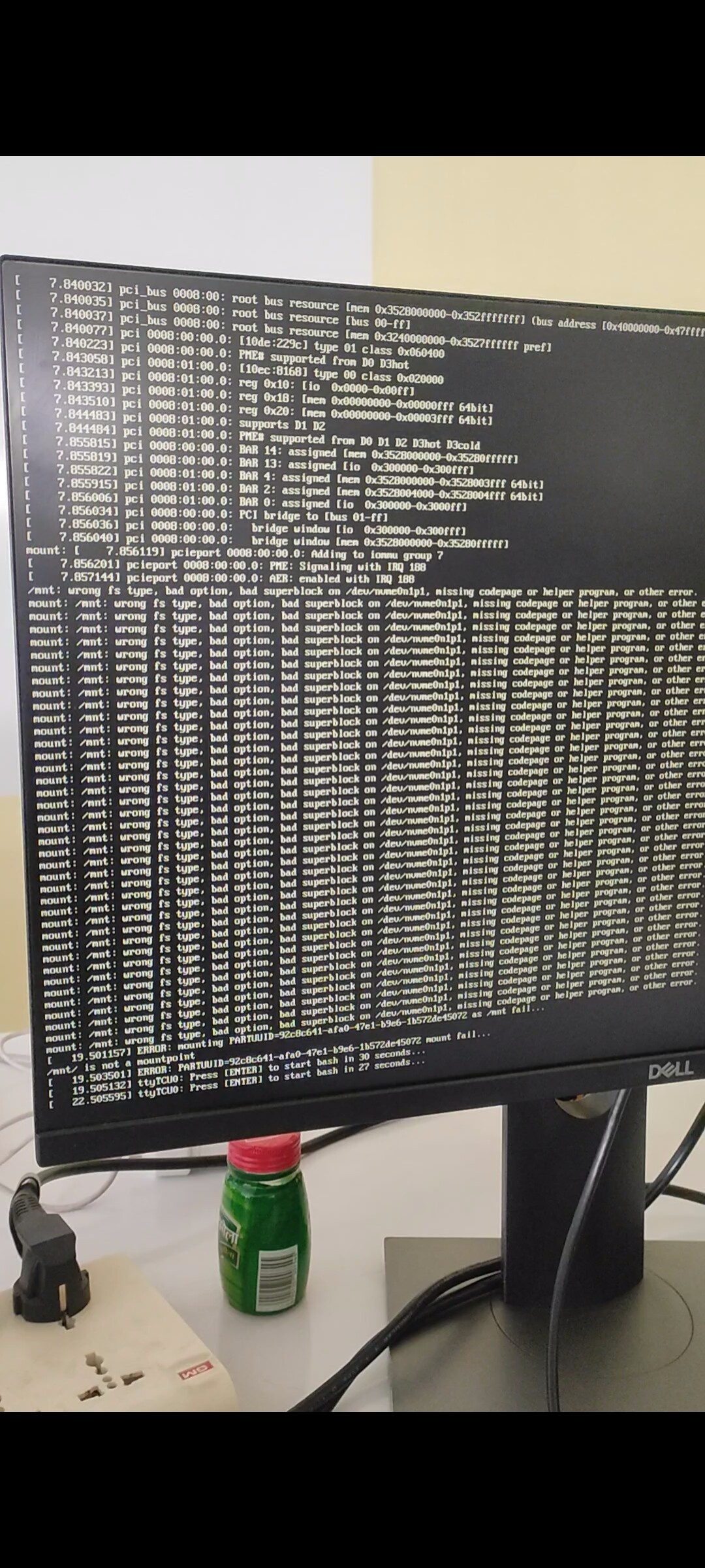

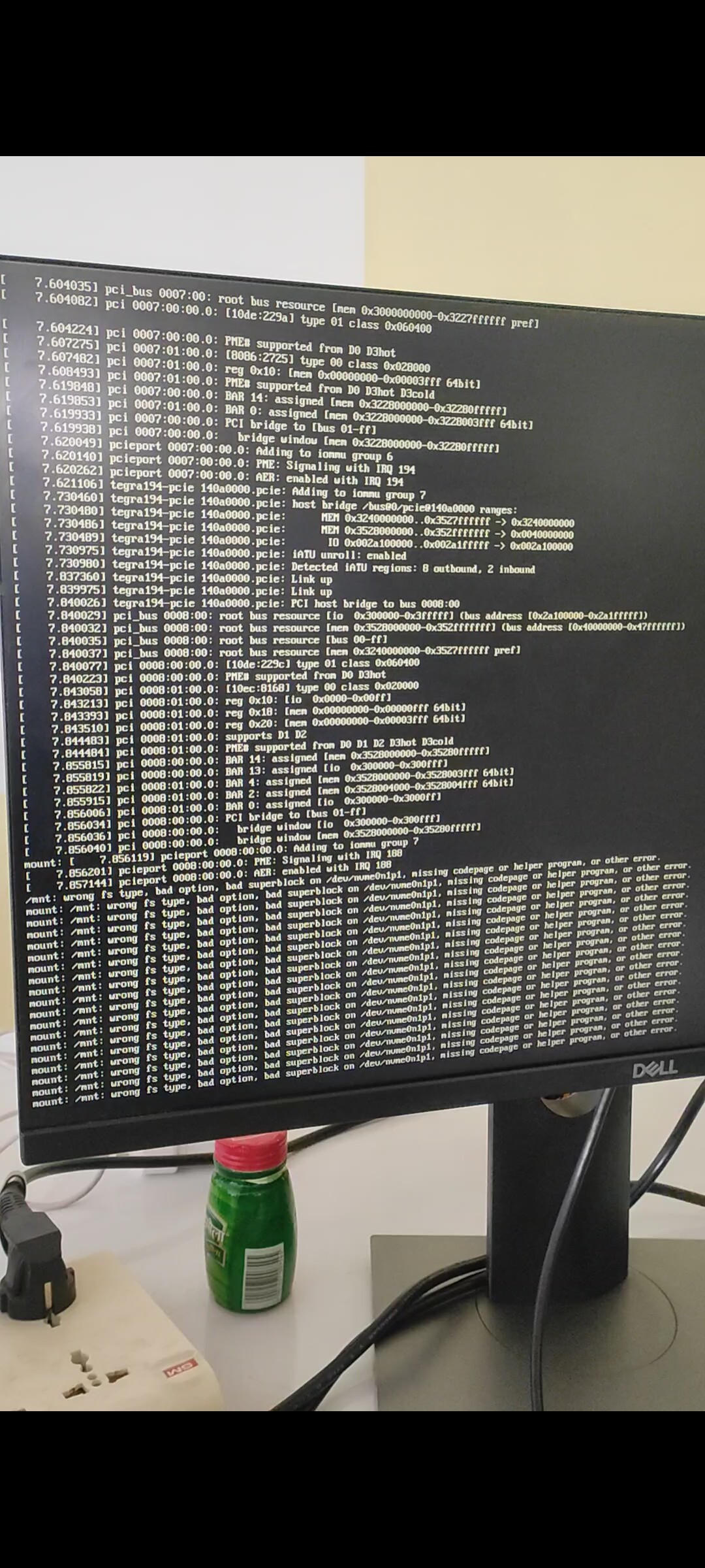

I’m trying to flash my device but I’m hitting the same issue: the device only boots when USB is connected — it will not boot successfully without USB. I’m attaching the host machine logs and device screenshots below.

Device screenshots
Any detailed steps or commands to try would really help me debug and solve this.

Hi @karthikreddy157
You must reflash the device because the file system looks corrupted.
