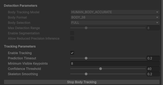

I recorded a video and used the BodyTrackingSingle example scene to test this, but I don’t see any movement in the fingers that are supposed to move.
Is there something I’m missing here?
I’m attaching the video with the test, and the configuration in the ZedManager
Thanks a lot

Hi @R2R0
Finger keypoints with the shape BODY_38 are primarily designed to help estimate hand orientation.
The accuracy is not sufficient to estimate precise finger movements.
