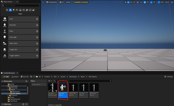

I followed the steps to create a IKR_ZED_Manny, then it works well!!
Create a IK Rig for SKM_ZED_Manny
In the IK Retargeter
