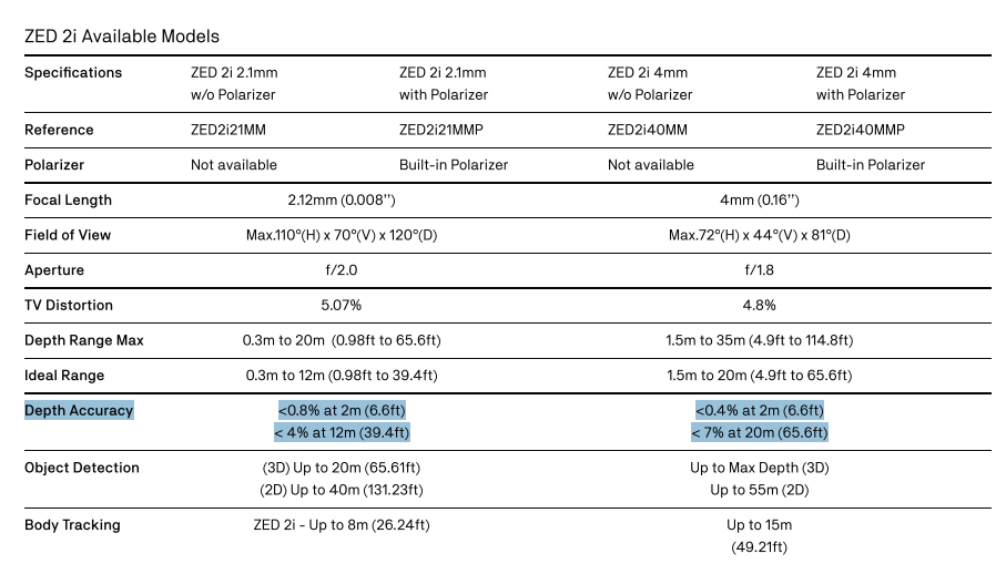

Hi @Pentz
The information you’re looking for varies depending on the condition, the optics, your software configuration, and the type of surface being analyzed.
The datasheet contains an estimate of the percentage accuracy:
