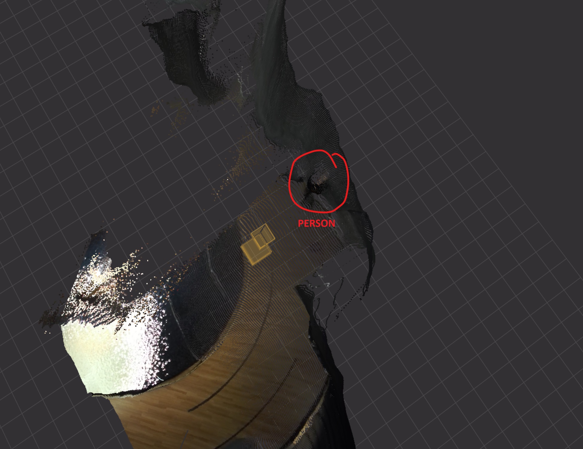

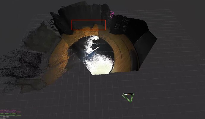

Hi, we are using a customized Object detection multi-camera sample using two cameras. See the below screenshot of the setup (720p, 30fps, ULTRA, because we experienced some crashes with the NEURAL module during longer runtimes).

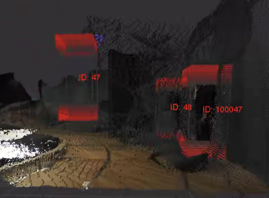

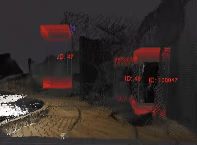

As you can see, only parts of their tracking space overlaps. When a person stands in the area marked red, it can happen that they produce a ghost detection that is strangely placed ~1m in front of them. See the next screenshot where ID 47 and 100047 are the same tracked person, yet placed at different positions with the bounding box of 47 hovering in mid-air.
Even if the person walks, both the correct bounding box as well as the “ghost” moves with them. Interestingly, this happens significantly more often, if not only with people wearing dark clothes. My best guess here is that the pink camera produces the correct, the green one the incorrect tracking. Any ideas what could cause this issue?

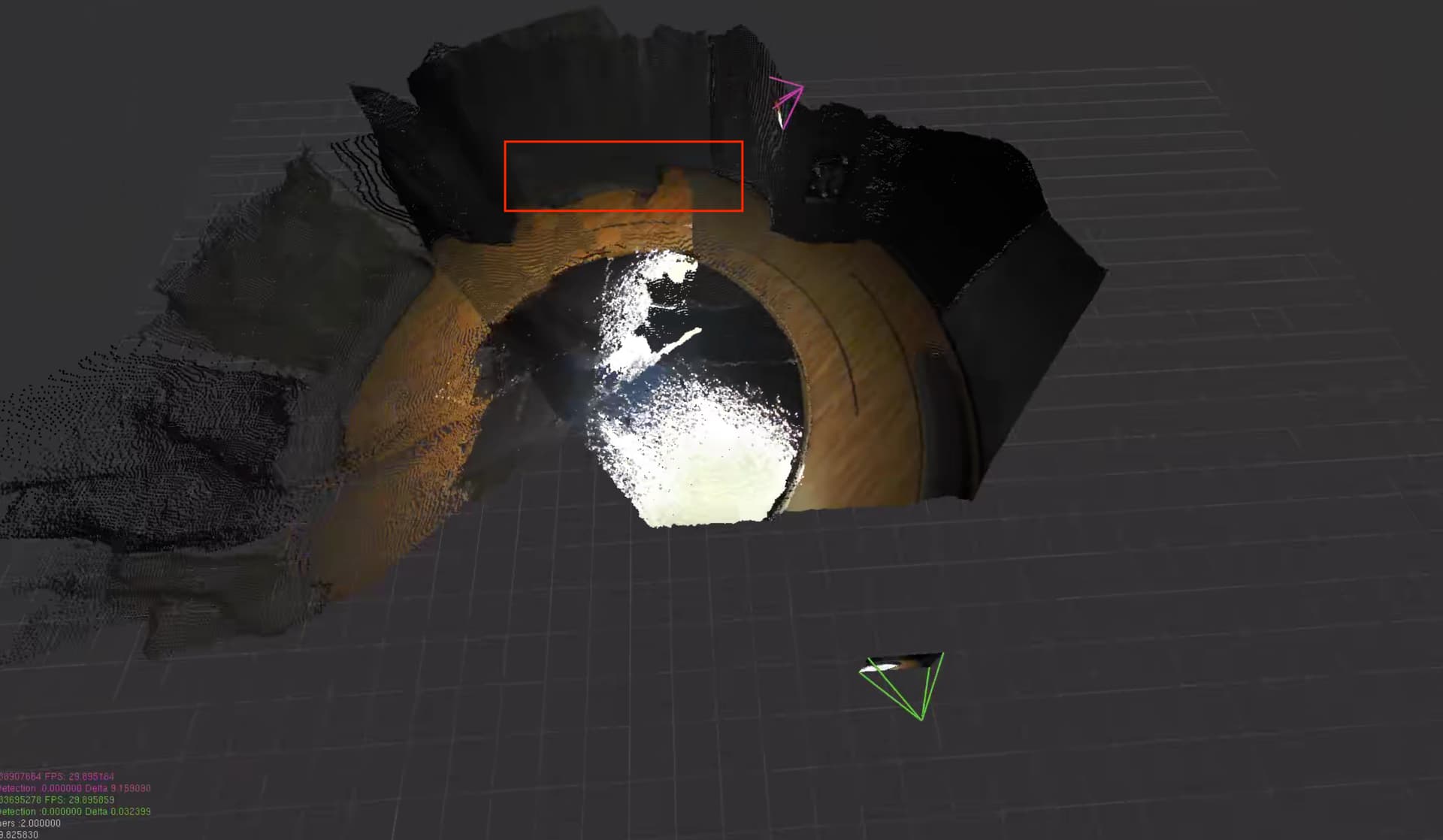

Here is another video showing the issue. As soon as the pink camera looses the tracking, the bounding box is at the wrong position. As you can see it looks like the cameras are miscalibrated. But then I would expect to see that reflected in the point clouds being misaligned and for that issue to happen constantly.
