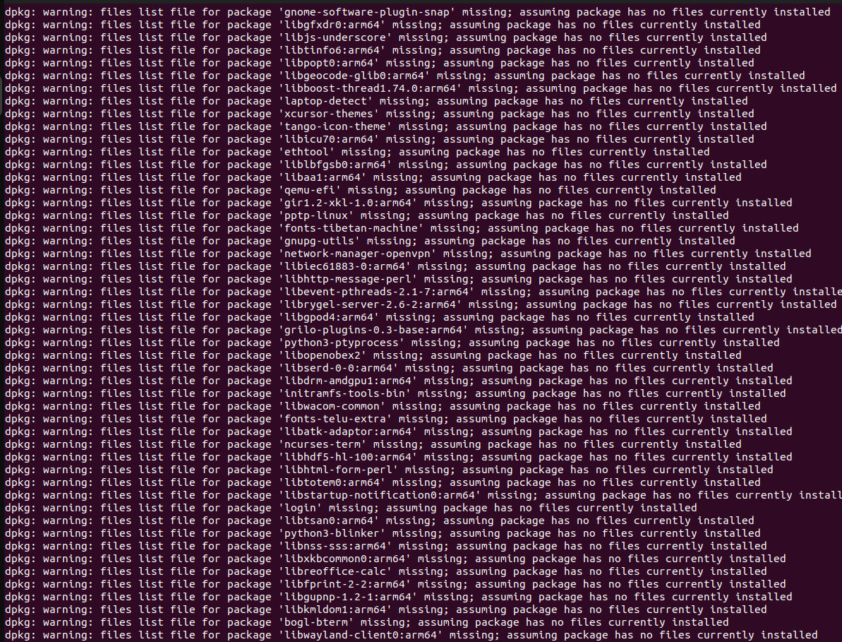

I am using a ZED Box Orin which originally came with NVIDIA® JetPack 6.2 / L4T 36.4.
I previously downgraded to NVIDIA® JetPack 6.0 / L4T 36.3, but later I flashed it back to NVIDIA® JetPack 6.2 / L4T 36.4 again.
Now, when I install the ZED Box SDK, I see a warning message as shown in the attached image.
I would like to ask whether this warning affects normal operation or system performance.
Thank you.

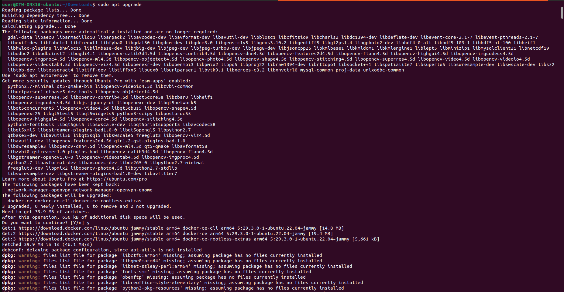

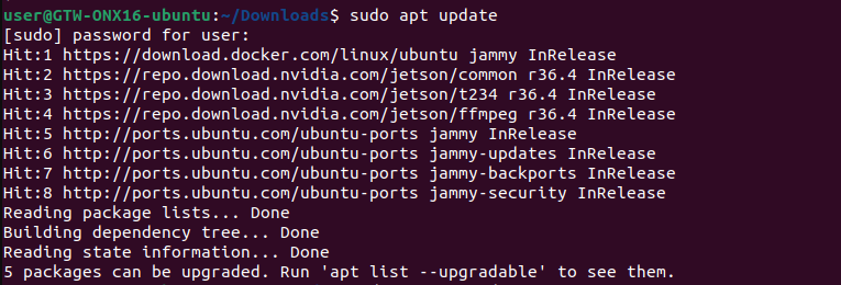

The first time I ran sudo apt update,as shown in the image below.

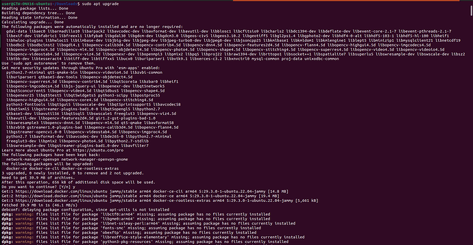

Then I ran sudo apt upgrade,I saw the warning shown in the image below.
After that, when I ran sudo apt update again, the warning no longer appeared, as shown below.
