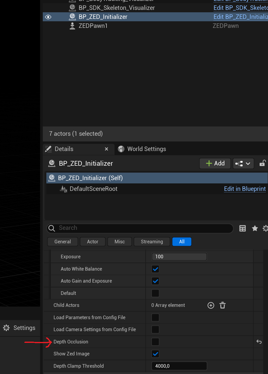

This is just a checkbox on the Initializer blueprint that comes with the ZEDSamples Unreal Project, this is the ‘L_BodyTrackingMulti’ level.
If I disable said checkbox, it cuts the camera feed in half like in the initial post.
It does however still track human bodies.

I need the Depth Occlusion turned off because I’m trying to create an application where you overlay clothing onto tracked humans. Therefore I need the ‘Show Zed Image’ to be enabled, but then it cuts the camera feed in half.
