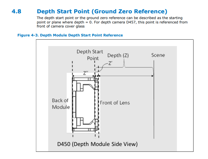

I looked at the datasheet for the Zed-X mini (https://cdn2.stereolabs.com/assets/datasheets/zed-x-datasheet-march-2023.pdf) but nowhere in it specifies the offset from “zero” depth to the glass plane.
If you look at the datasheet for the Intel Realsense (https://www.intelrealsense.com/wp-content/uploads/2022/10/D457-Datasheet-092022.pdf), you can find a figure that specifies the distance from “Depth start point” to “Front of lens”:
I’m hoping something like this exists for the Zed-X mini.
Sorry for the confusion, unfortunately this reference is not available yet in our datasheets. You can consider it to be 1 cm from the back of the module (for instance, according to the picture you shared the Z’’ is equal to 1 cm in the ZED X Mini).
