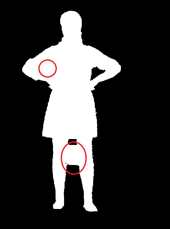

I’ve created a test app in C# where I want to filter out everything but person’s silhouette (using distance threshold). However the depth image contains artifacts as shown on the picture below - parts of the background merges with the silhouette. The ZED depth viewer shows the same results no matter the parameters (using Neural Plus model). Will this be improved anytime soon or do you know of any approach (or filtering) how to remove such artifacts? Thanks a lot!

Then I use MEASURE.DEPTH_U16_MM to get depth image and discard all pixels that are further then specific threshold. To remove floor, ceiling and side walls, I use pointcould pixel values.
I experience the same behavior (silhouette not well separated from background) also in ZED Depth Viewer. The problem is present even if the person is wearing high contrast clothes in respect with the background. In that case the silhouette is perfectly visible in the RGB stream, but not correctly cut out using the depth values. I am trying to accomplish kind of green screen effect in normal room conditions. I’d be glad for any suggestions how to combine streams or use any filter that would result in better silhouette extraction.
Thanks and KR,
Tomas
This is the issue. Please try to set it to false and eventually use runtime_parameters.confidenceThreshold to tune the depth quality.
I recommend you set this to 100, or a close value.

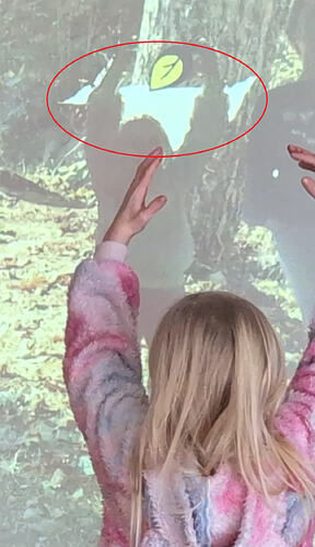

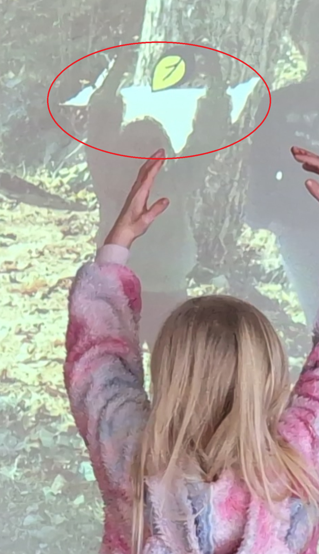

thank you for the info. Changes of confidence and stabilization improved the results to certain extend but haven’t solved the issue entirely. See the image below. The camera is in the height of cca 70cm. We are filtering out pixels past certain distance (5m), ceiling, floor and side walls using pointcloud information. Yet child’s silhouette contains the artifacts - in this case it is a portion of the ceiling. Sometimes this appears between 2 persons - portion of the background forms an artifact.
Please could you suggest an approach how to filter out these artifacts without using machine learning image matting?
