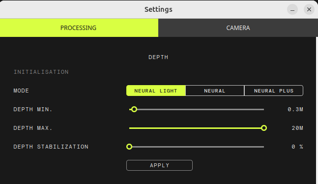

We suspect it’s coming from incorrect tracking poses, which impact depth stabilization and could produce this jittering. This could be due to corrupted IMU data or a bug in the positional tracking.
If possible, you could try disabling the depth stabilization by setting it to 0% to test. We’ll continue investigating on our side.
Turning off the stabilization seems to make it better. But depth quality gets worse. I hope this gets resolved soon.
