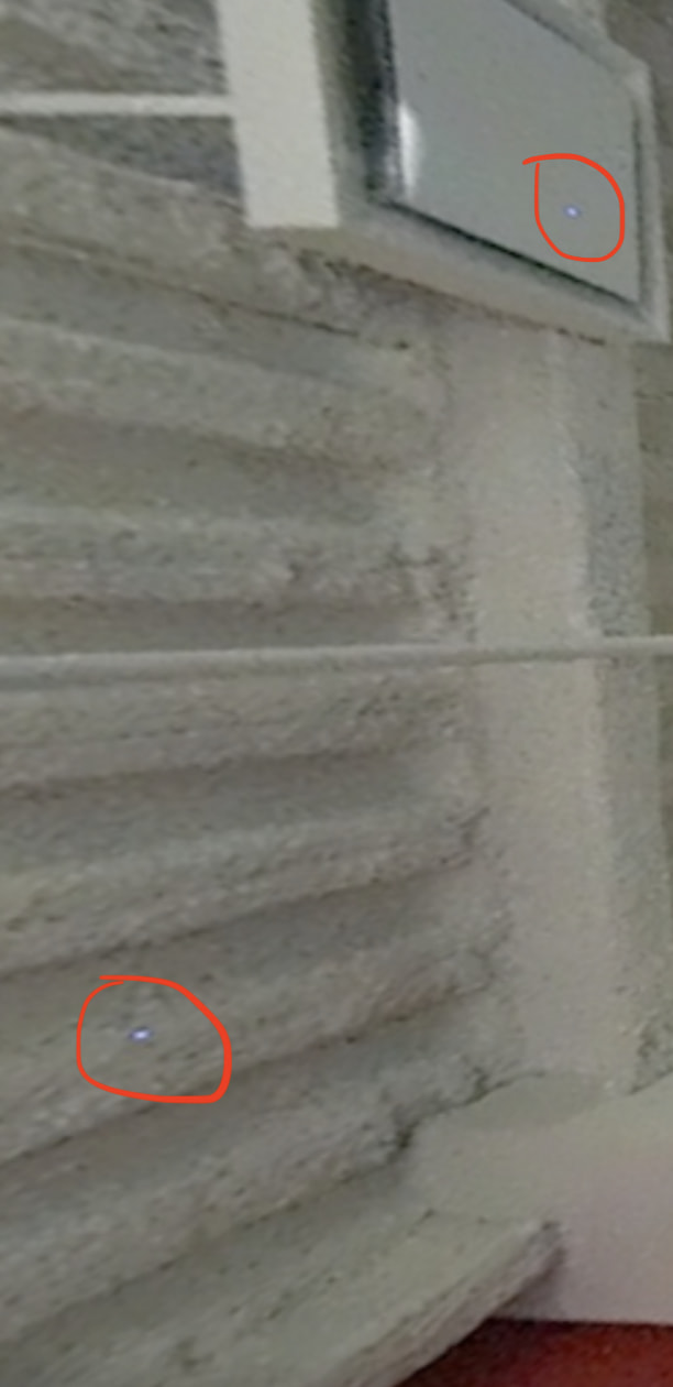

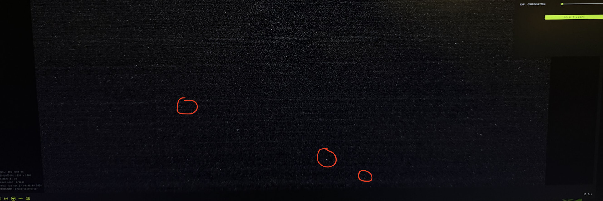

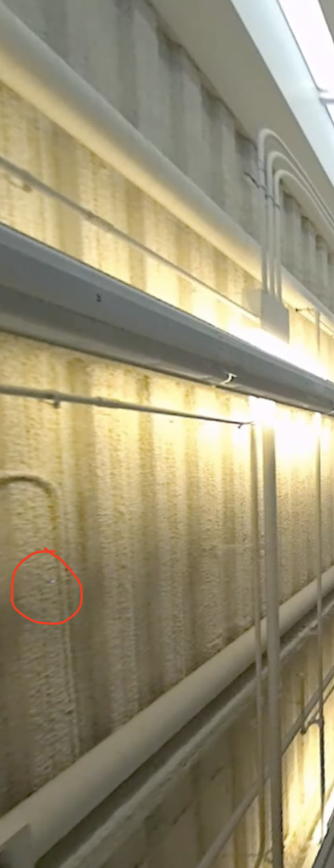

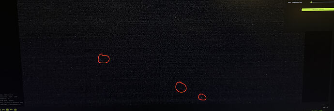

I’ve noticed that there are pixels on every one of our cameras that has some artifact that resembles a dead / stuck pixel.
Example images:
These pixels are usually white, sometimes red. It is not noise, as they remain in the same spot in the image across power cycles and even in well-lit environments.

Hi @s.ven,
Has anyone seen this before / is this a known issue or accepted?
Yes, this is known and accepted. Isolated defective (hot or stuck) pixels can be present on the image sensor from production, and can also appear during the lifetime of the camera. They should not affect depth, positional tracking, or object detection results. A sensor is considered defective only when there is a cluster of 2 or more adjacent defective pixels; in that case, please write to support@stereolabs.com with the camera serial number and a ZED_Explorer image showing the cluster.
The sensor of the ZED X Mini and the ZED X One S/GS also supports a runtime dead pixel correction. It is disabled by default because, with exposure values very close to the frame time, it can create flickering. For a ZED X One S:
sudo i2cset -y -f <bus> 0x10 0x31 0xe1 0x0F i
<bus> is the number in the path reported for the camera in the GMSLList section of your diagnostic file, for example 9 for /dev/i2c-9. The command does not apply to the ZED X One 4K, which uses a different sensor. For the ZED X Mini, both sensors must be configured; let me know if you want to test it and I’ll share the addresses for your configuration.
Thank you @Myzhar. The defects do not appear as clusters larger than 1 pixel in the cases we have seen so far.
