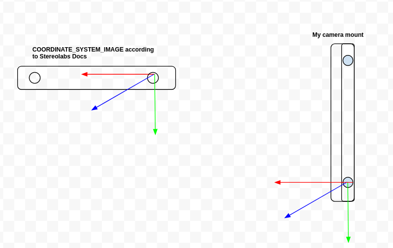

I just want to make sure that I get this correctly. If the initialization if set so that Y-axis is going down towards gravity, then for a vertical mount of the camera, the coordinate orientation will be as I show in the drawing:
The orientation of my mount is that camera is flipped and rotated, basically :slight_smile:

@erminkev1 if the parameter set_gravity_as_origin is true, then the image that you published is correct.
